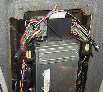

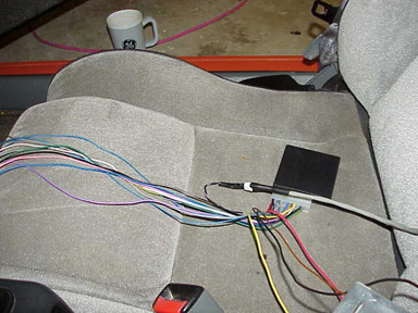

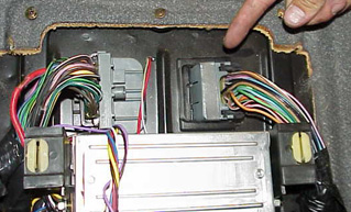

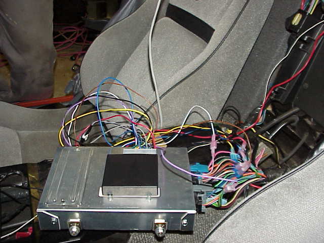

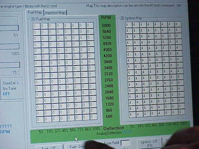

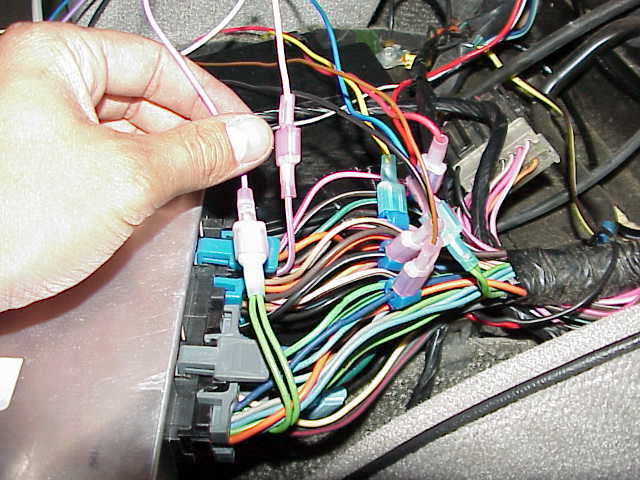

well the new laptop programmable engine management system is in and working...
took about an hour and a half to install.. would have been quicker but i'm an idiot. i wasn't listening to Ed and hooked up a wire wrong; FRIED the ICM.. so we had to run and get another one. anywho.
this thing Data logs, reads O2! adjusts injector pulse width, inj voltage, Map voltage, TPS voltage, timing advance/retard has both a 3d and a 2d timing and fuel map adjustment, with a grounding wire for a high boost or nitrous map(B) can control up to 8 additional injectors, all the size of a deck of cards.. just plug in your laptop and GO. it's sweetness! Pics soon to follow.
the new unit having data logging ability will retail for $340+ shipping.. i know i said $250 but it's WAY better now.. and still a sweet deal at $300 shipped (in cont. US e-mail me if your outside the 48 states and i'll give you a more exact shipping price) with vehicle specific instructions, and both mine and Eds technical assistance for tuning and installation.

What kind of resolution does the software/ECM have? You quoted changing something at 4300, which would lead me to believe it has tuning for every 100 rpm. Also, any idea of what ranges the tuning capability has? For example, how much can we tweak the TPS voltage or pulse width?
Thanks! You better make sure and let us know how to wire it up without killing anything.

Report this Post05-02-2002 01:35 PM Click Here to See the Profile for 1FST2M6Click Here to visit 1FST2M6's HomePageSend a Private Message to 1FST2M6Direct Link to This Post
for the BEST results running it on a dyno would be the ideal.. but you can tune at a local drag strip. but dyno would be the perfered way.
you set the parameters of adjustment.. 0-1-0-1 or % 1-100%, you set the RPM scale mine is 600 to 6000, there are i think i don't have the pic in front of me or the program BUT it's like every 200 rpm (my set up) and at any percentage of throttle opening not just WOT. but better for cruising aroud town.. or running with a hollow cat in an emissions state you should be able to program more timing in it to lower NOx with out killing CO or HCs with added fuel. (but that wouldn't be exactly legal)
if you are remotly familiar with the software you tune the car on the dyno.. instead of paying for their learning the software. it's REALLY easy.. seriously. just click the block, set the value, save, run it and see how it was, repeat till your satisfied or have squeezed the last shread of HP from it's grasp.

only power, ground and ignition hooked up...
all hooked up and ready to put the center counsel back on.. you can see the grey braided lead to the right with the white plug.. that goes to the cable to plug into your laptop.
just one of the many screens to manipulate fuel and timing dependant on throttle position and vehicle load. (vacuum)
looks worse than it realy is... just make damn sure you hook the correct wires up.. the pink and white to red NOT lavender and black to red. NO NO NO!! lmao..
t-taps, male/female sheilded connectors.. and a little patience...

He made a bracket too! lol.. just double sided tape so it doens't rattle around and annoy me and cause it's own destruction.
(before anyone askes.. the red and while wire in the center of the 2 plugs.. injector duty cycle for my monitor and oil pressure sending unit line to the autometer guage)
