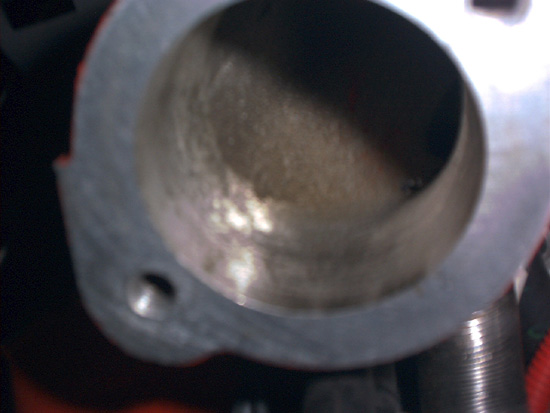

Add me to the list. Darrell is great to deal with and the work is beautiful. You won't be sorry.
You can't see the inside of the plenum here, though.

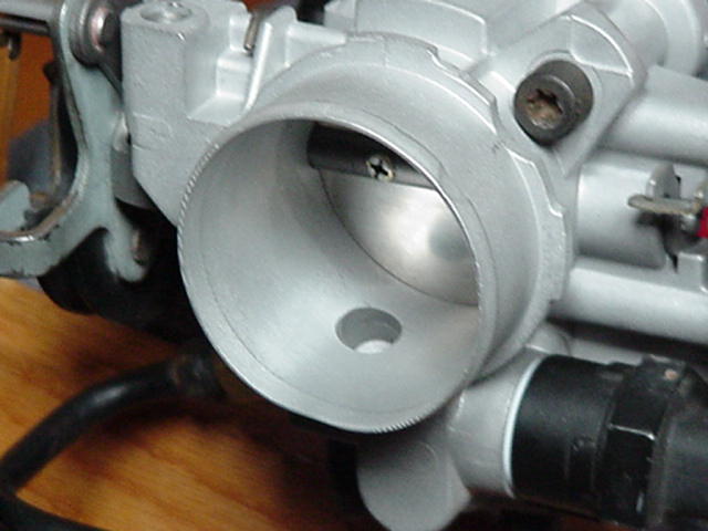

I also have my V-6 TB and plenum done.
Here is mine from Darrel Morse.
If they are too big I apologize.

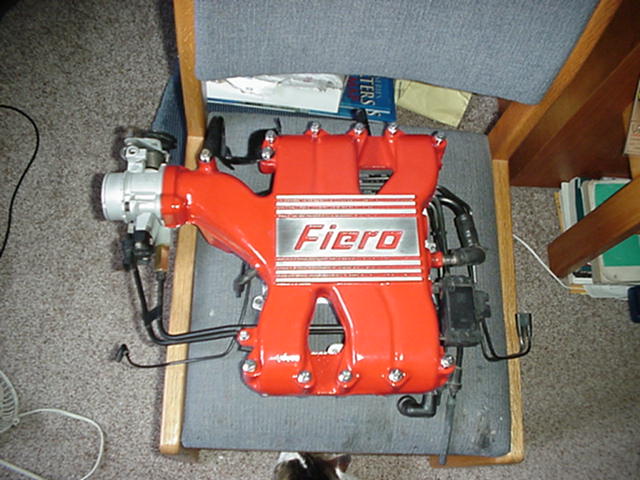

Here is mine out from Darrel.
