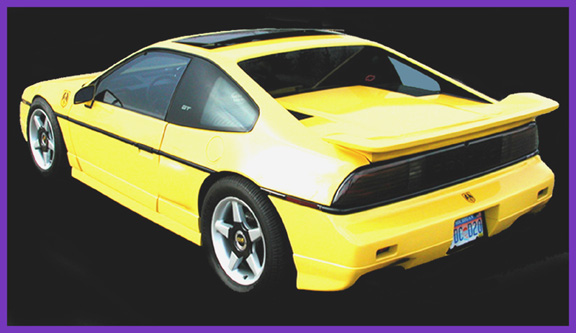

This might help you out a little. The wheels are 16x7.5 front / rear with a 5 3/8" offset/backspacing, tires are rear 245x50, front 215x50. The car is lowered 1 1/2" front and rear with no tire clearance issues to fender wells (but it's close).
Note: Wider tires are going to be a little more sensitive to road tracking, if your front end alignment is off a little it can be a handful. You might want to us a road course setting on the front where the wheels are "tipped" just slightly outboard (similar to Indy car), works great on mine (don't have specific numbers to give you, but it doesn't take very much and you won't notice bad tire wear).
