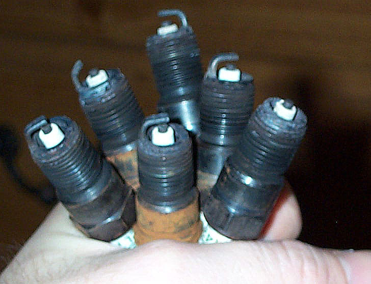

My plugs! The simplest thing. The funny thing about it is that I did a tune up before I left on my trip to Wisconsin a couple weeks ago. Plugs, cap, rotor. Driving up in Missouri it didn't want to go up the hills or above 70 on straight roads. Since I just happened to be in the area of Kenosha/Barrington I stoped by Archies for his open house. Awsome. I got a ride in the Finale, Archies daily driver. Unbeleavable. It's a totally different car with the V8. Now I'm getting off the subject. Archie only workes on V8 cars. Dosen't like the v6. That's why they call him v8 Archie. He was a great help. Took time away from his business to try and make sure that I made it home. They changed the fuel pump and the filter. The pump was starting to go bad but that didn't solve my problem. Next day. I took it to a local muffler shop in Kenosha. New cat converter. Bigger than stock, and it did make the car run alot better. As soon as I got back in to Missouri the car wanted to puke again. So today after replacing some other components I decided to take a look at my plugs. Wow. That's messed up.
I looked in the book and it tells me wrong heat range or preignition. The plugs I'm using are AC Delco R42LTS. Is that correct? I just hope my engine is ok.

Too late. Thanks Pep Boys. Another Fiero dead. They gave me the wrong plugs. I didn't think to look. They were longer. Too hot. Now the valves on #5 are probably bent. Since I'm laid off I guess I have time to fix it.

On the melted plugs...
They gave you correct heat range, R42CTS (CTS is for Copper Tapered Seat, your L is for long ceramic).
http://www.fieroownersclub.com/doc.htm has this recommendation.
Sorry to say... you leaned it out on your long drive with teh restricted filter and weak pump... not the plugs fault.

It's nice to have spare parts that are rebuilt just laying around. I have questions for replacing the head. Should I use sealant on the head and intake gaskets? Or do they just get put on without?
About the plug #. Pep Boys gave me PN#R42LTS it was supposed to get R43LTS. In the top pic you can see how much it was sticking through the head by how much it was burned.

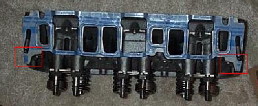

And Yikes! No sealant on Head Gaskets, a small amount of RTV in the corner of intake gasket where it meets the lip seals for intake.

Report this Post04-21-2002 02:56 AM Click Here to See the Profile for JetroGTSend a Private Message to JetroGTDirect Link to This Post
Are you talking about these areas?
I'll find out for sure when I pull off the head.

Report this Post04-21-2002 03:05 AM Click Here to See the Profile for Scott-WaClick Here to visit Scott-Wa's HomePageSend a Private Message to Scott-WaDirect Link to This Post
almost, other corners same picture
where the head meets the block

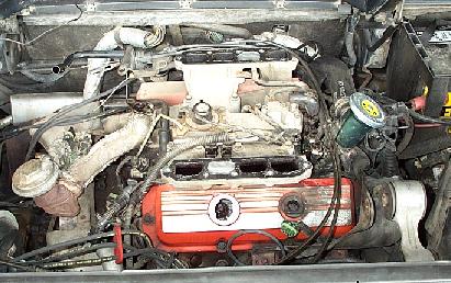

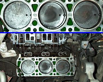

At 2:30 I started to get into it. I'm taking pictures every so often. Took a shot of the injector wire harness so I know how it all goes back together.
I guess I owe Pep Boys an apology. I don't think any one really cares about them any way.

My progress so far.
Yesterday. #5 cyl looked oily.
Today.
I'm taking it slow. I've never replaced a head before. Hardest part so far was to keep going.

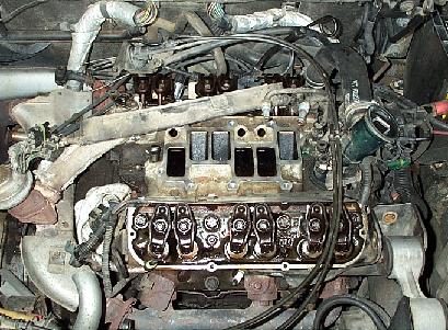

Mine is coming along nicely too.
After head removal:
Cleaned and waiting for heads:
Old head and new Fiero Store performance head:
New timing chain and waterpump:
Old and New 1.6-1 roller rockers/lifters/pushrods:
I should finish it tonight!

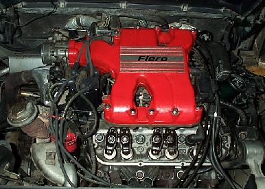

It runs! The nasty metalic noise is gone, but so is the egr tube gasket. It must have droped down on the engine somewhere. The tube looks origional so I'm ordering a new one. Other than that I should be good to go.
