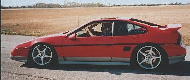

hey slammed, that looks SWEET what drop are you running and what kit is it, and from where.
