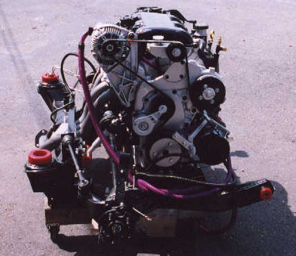

Like this?
Don't mind the mess in this pic
My motor is out of the Venture Van...I went a bit overboard on my swap. TecII engine control, etc. Its FAST I had to make a scoop/vent in the lid, because of the high mount alternator(not sure if this would be necessary on a GT. It bolts up fine, but you have to put a "dogbone" torque strut somewhere. Like will said, a new front mount is necessary. Do a search in Gen chat for 3400. I have a whole mess of pics there somewhere.

Yeah, I notched my lid, and took out the torsion springs.
I suppose you could convert the front stuff...but with the 3400s nice clean look and the 20 minute water pump change, lack of squeeling belt, which takes all of 10 seconds to change...why! Just duplicate my front mount and you're all good

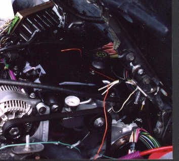

[Edit] Wanted to add some pics.

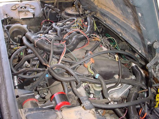

It took me all day to go from this:

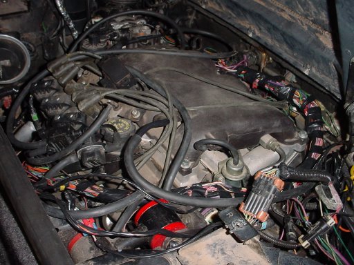

To this:
In case anyone cares, this is a 3400 from a 97 Olds Silhoutte using the stock Sihoutte computer (thanks Joe!) and all Fiero accessories.

Do you have a better pictures of your front mount? I can't see enough to duplicate it.

Exactly what parts did you use from what? I was thinking of using the Fiero timing cover with the Fiero waterpump, Fiero A/C compressor and alternator mounts. In that case there wouldn't be a hole where the waterpump goes beause the waterpump's in place... Unless there's a significant change to the block of which I am not aware...
I guess you're using an automatic?
Also, is that intake stock? Did both of you grind the "3400 SFI" off your manifolds and powdercoat them black?

I used the timing cover and water pump from an 88 Fiero 2.8. The AC and alternator are from my 85 SE 2.8. I have a spreadsheet that details exactly what parts are used for the entire engine setup. There is a change in the block that requires plugging of the hole in the timing cover. Note, the bracket mounts for the AC and alternator on the side of the head are different on my engine from the 2.8. Someone on this forum has Gen III aluminum heads that have the same bolt pattern as the iron ones, but I don't remember who.
I am using the Muncie 4-speed (requires some computer fooling). The manifold you see is the stock one without any grinding. I guess the vans don't get the pretty one.
