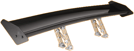

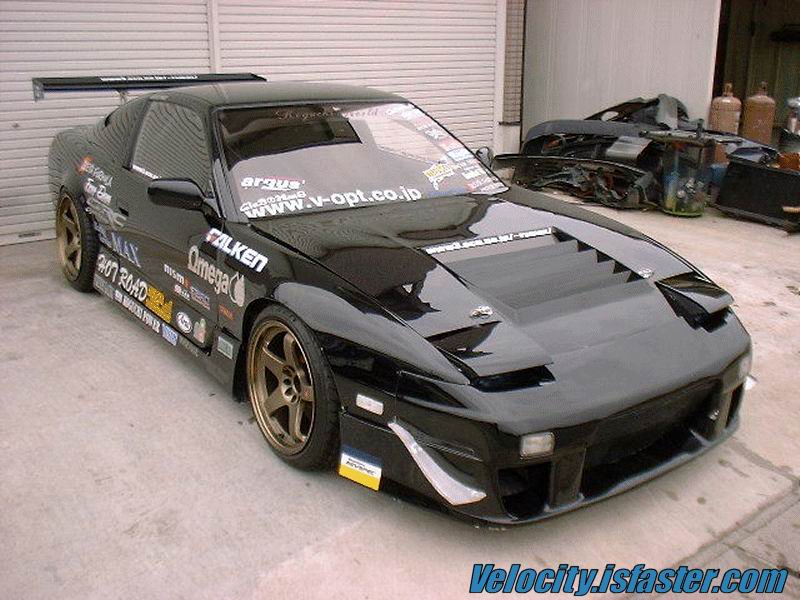

OK, we all know some people think these are jsut "rice", while others see them as being useful aerodynamic aids.
1) What is your opinion on this subject (stated NICELY, please. This is Cliff's board).
2) What basis do you have for your opinion.
PLEASE keep it clean, and concise.
This topic is NOT about fiberglass non-functional wings/spoilers, but only about real-racing-equipment aluminum and/or carbon fiber adjustable wings, like offerings from APR.
1) I personally believe people have the right to put whatever they want on their own car, whether for looks or for performance, and do my best not to make fun of them for it (unless they are claiming results they cannot attain from a product).
I do, however believe these are useful in everything form high-speed spirited street driving, to drag racing, to road racing and rally.
2) I hold this opinion because;
a) I have been racing (mainly autoX with limited road racing) for 7+ years, and have used one of their wings, with NOTICEABLE affect on handling from as little as 40MPH.
I have also used the "adjustable" function to adjust rear traction on tight high-speed corners, with noticeable results.

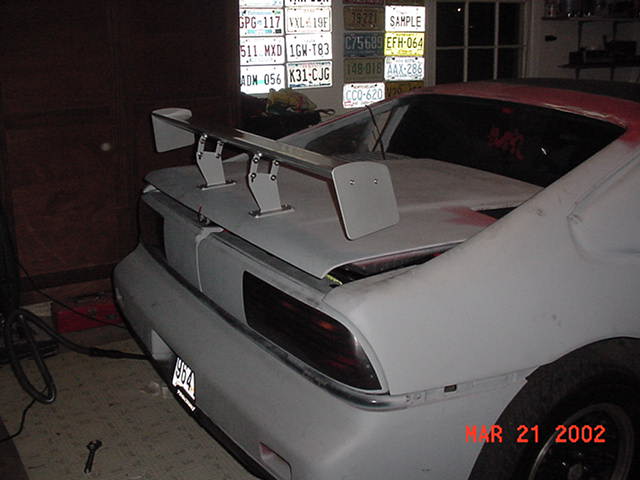

In this picture, You can see my aluminum APR adjustable wing. I feel it has provided a little more downdorce on teh already heavy rear end, providing (although minimal) better handling characteristics

Blacktree
Posts: 20770
From: Central Florida
Total ratings: 350
Report this Post03-26-2002 11:10 PM Click Here to See the Profile for BlacktreeClick Here to visit Blacktree's HomePageSend a Private Message to BlacktreeDirect Link to This Post
"1) What is your opinion on this subject (stated NICELY, please. This is Cliff's board)."
A rear spoiler can do some good, but to see a noticeable improvement in aerodynamics, it must be used as part of an "aerodynamic system". The stock Fiero spoiler doesn't do anything for downforce, because it isn't anywhere near the airstream coming off the roof. Set it up on 7" tall stands and you'll see an increase in rear downforce.
And one more thing. Those skinny spoilers don't do much either. You need a nice deep spoiler with a noticeable angle of attack. The stock Fiero spoiler is pretty deep (about 10" if I remember correctly) and has a nice angle of attack. It just isn't placed high enough.
"2) What basis do you have for your opinion."
Two things:
First of all are the wind tunnel charts I've seen for the notchback Fiero. If you look at the profile of the Fiero, the roof drops slightly towards the rear deck. Likewise, the airstream over the roof drops a couple inches as it travels over the decklid. At the rear of the decklid, the airstream is about 8"-9" above it. Perfect height for 7" tall spoiler stands.
Second is the real-world results I've seen from the boosted spoiler on my notchback SE. I don't race the car and don't drive it over 60MPH very often, so I haven't noticed much of an aerodynamic improvement.
However, whilst driving on a road trip, I got to see some visual clues to the improved aerodynamics. I was driving down the interstate going about 70MPH and it started to rain. I looked out the rearview mirror and my car was kicking the water mist up so high that it was plastering the windshield of the semi truck behind me. I thought it was an interesting role reversal.
