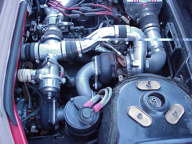

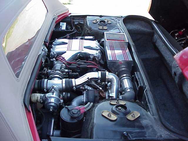

There is enough room for twin turbos in the Fiero as you have seen. I tried it but before it was fully completed I converted to a single turbo. I failed to connect the ground strap so the engine leaned out and went into detonation within a split second upon acceleration. I didn't discover the problem until after the conversion. The T-3 Garrett and the Mitsubishi turbos in a dual setup are border line too much for a 2.8 unless you intend to run high rpm and high boost pressure ~7000rpm/15 psi. A single Mitsubishi turbo is on the small side for the 2.8L while the T-3 especially with the .63 turbine housing from the ford cars is about just right. I have tried them both. Too little turbo gives you low rpm power, mid range to too much turbo gives you better top end performance, check the literature available. I'm currently running a T-3 on a 3.4L and about to build a twin turbo 3400. I'm going to use the T-25s from the 2.0 Turbo pontiac cars which are smaller than the mitsubishi and more suitable for space constraints. You really have to research and understand the use of turbine and compressor housing A/R's to determine the type of turbo to use. Someone mistakenly said that twin turbos reduce top end performance. It's all a matter of efficiency, if twin turbos allow the engine to breath better at the same rpm and boost pressure than a single turbo you'll have more power. I prefer a single turbo to twins however to reach the level of exhaust flow for the engine size and boost pressure I want to run it's more cost effective for me to install twins instead of purchasing a single larger turbo.
