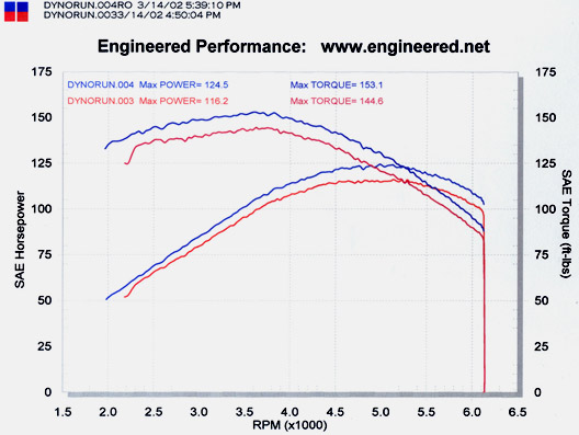

I put my race car on the chassis dyno a couple weeks ago. I thought you all may be interested in the results. If I did everything right the dyno sheet is posted below.
This motor has ported exhaust manifolds and a relatively free exhaust. I'm running Joe Wynman's computer chip. Other than that it is completely stock and it has about 160k miles on it. Peak torque was 149.8 lb-ft at about 3600 rpm. Peak hp was 115.8 at about 4600 rpm. This is a 17% loss from the 140 hp at the crank that GM claimed, so it sounds about right.
One thing I found interesting is that the tach isn't accurate. On both runs I didn't back out of the throttle until the tach said about 6200 - 6300. The dyno sheet shows that this is really 5600 - 5700.

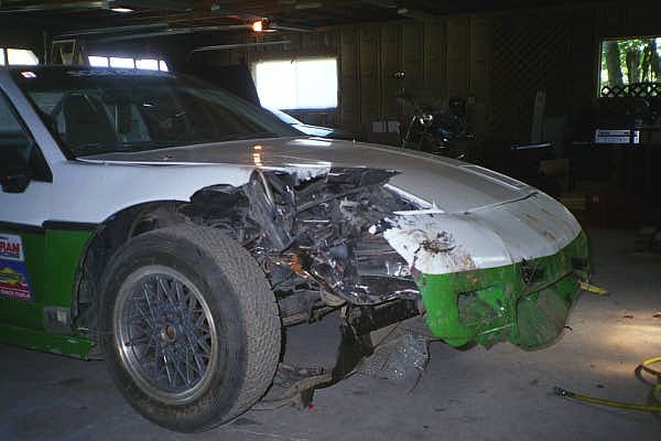

Glad to see you on the forum Doug. Is this the green and white car that had an incident with a tree at one point in time?

Is it an auto? If not, maybe you have a slipping clutch?

The tach error wouldn't be caused by a slipping clutch. They usually use an inductive pickup in order to get the tach reading. Otherwise they would need to calculate gear ratios, tire sizes etc. which wouldn't be very accurate and could cause that much of an error.
I am not sure if this is what you meant though due to your limited response. Would you care to clarify?

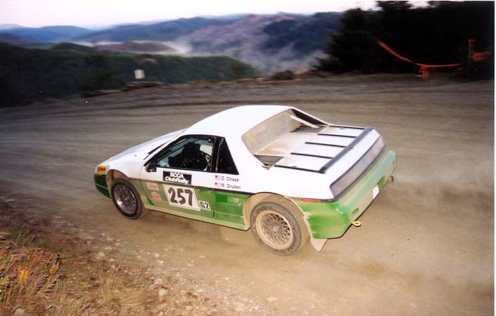

Yes, it's the green and white car that had a run in with a tree.
It's in better shape now. Here's a pic from the last rally on March 2-3.
No, the clutch is not slipping.

looks like your having ign. mapping issues in the upper rpm range... with 160k it should still pull better.. have you done a leak down or compression test? i just dynoed an 85 that made 124/153 (MylesF7s new toy)
https://www.fiero.nl/uploads/mylesf7dyno.jpg
put the stock chip back in it.. i bet it'd run better.

Since the exhaust mainfold mod is documented good for 8 hp that would put the driveline loss at >25%
that makes more sense when you look at recent 3.4 dyno runs.

does it make ya nuts when they scale the hp and torque differently ?
they should be the same at 5252 rpm, not 3000

From what I remember Wynman's chip only altered a few things from the stock one. So the fuel curve is still the same. The major thing it eliminated was that annoying bump when the fuel cuts in at around 2000 RPM.

something to keep in mind
drive line losses are fairly constant
25 % of 140 hp stock (?) is 35 hp
drop in a bigger engine (200HP) the losses are still 35hp not 25 % (which would be 50hp !)
Yep. And he disables the EGR in software. That's the primary reason I have it since I removed the EGR hardware.
I noticed no seat-of-the-pants performance difference between the stock chip and Joe's.
