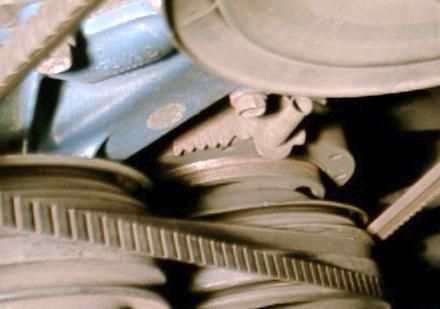

Just to add "yet another timing tab" picture to the archives....
(edit: Oh yeah, this is on an '88 engine which MIGHT look a bit different - but not much)

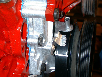

The following picture is a GM 2.8L in a 1986 Jeep.
The timing tab is on the right-hand side, and reads up to 20 degrees of advance.
Hope this helps... (?)
