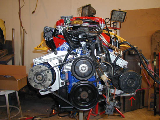

Also, where is the AC compressor belt adjusting bolt?
Arrow in pic points to adjustment bolt. It is in the groove on the silver bracket. You might also want to look from underneath the car to find this bolt.
Do I have to adjust these bolts to take off the old belts and put the new ones on? Or does it just make it alot easier to do. Thanks
Yes, in order to get the belts off you must loosen the adjustment bold on the AC comp to get the V belt off and then loosen the adjustment bolt on the alternator to get the serpent belt off. Once the belts are removed, you can then remove the crank pulley.
