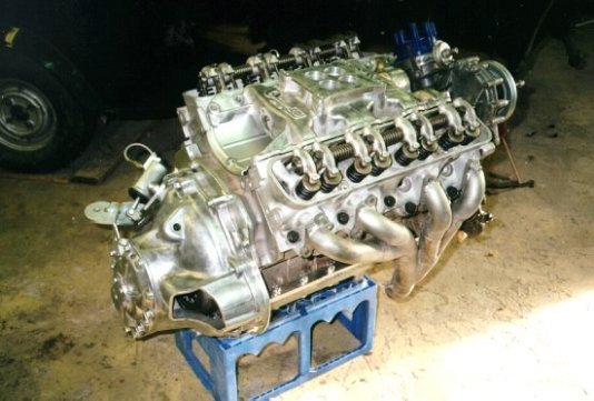

Here's the Australian equivelant Rover engine. They are plentiful and cheap and come in 3.5 ltr or 5.0 ltr. Parts are still plentiful here, performance goodies too. This one is bolted up to a Leyland Mini gearbox. Yep they even fit in a little Mini.

Hey Aus is that V8 Sitting on some kind of weird aussie milkcrate???
Mmmmmmmmmmmmmmmmmmmmmmmmmm..............Aluminum............

I don't know what that engine is sitting on actually. Yes REPCO heads can still be bought. Repco is a pretty large organisation these days and still makes everything the used to.
