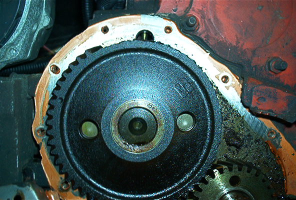

Heres the latest pics taken a couple mins ago

OMG!!
That just WRONG!

So what's the problem? You still have some teeth left on the gear.LOL Was that thing running like that? WOW.

I couldn't believe half the teeth were missing, I believe that once 1 tooth goes, it screws everything up and it just starts like dominos, I was in 3rd gear doing about 45mph when it died on me, high torque and it ripped until the 7th planet from the sun was distroyed.

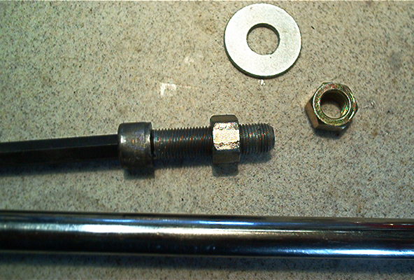

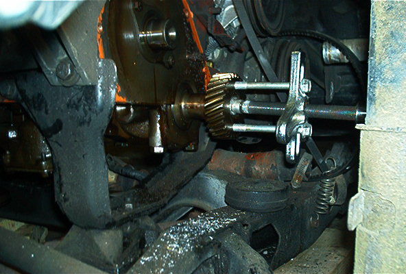

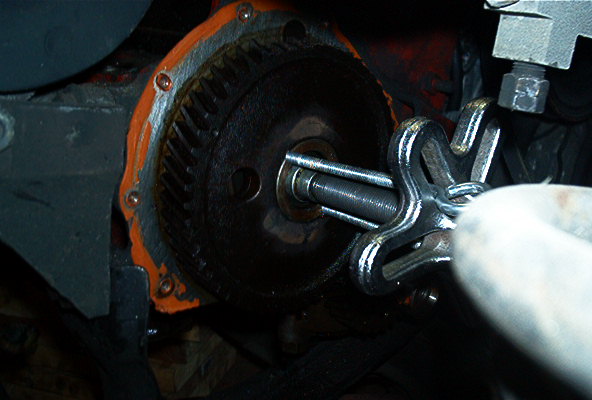

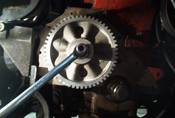

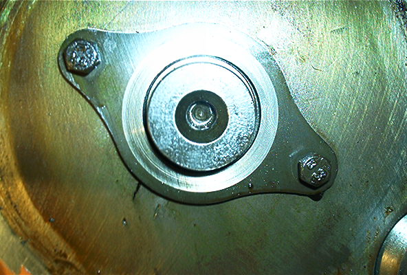

Update, removal of Gears!
I want to thank Ogre, his explaination has
made this possible.

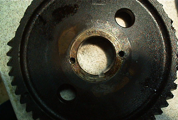

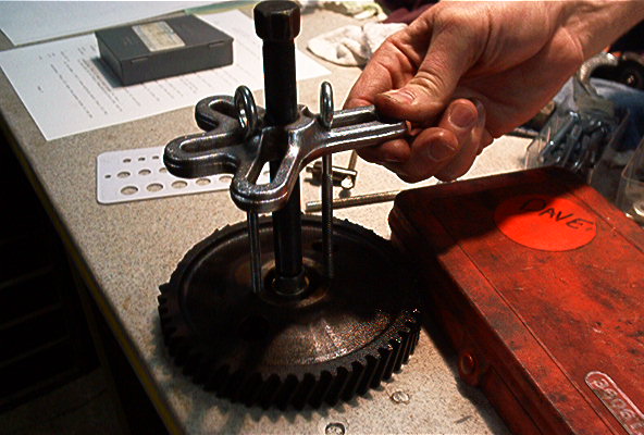

The Gear with 2 1/4 tapped holes in the metal
part surrounding the Cam.
heres the Gear Puller attached, timing gear is coming out.
Heres ME with my dirty, but warm garage cloths on.
heres the gear removed
Heres the gear, with a good view of the holes

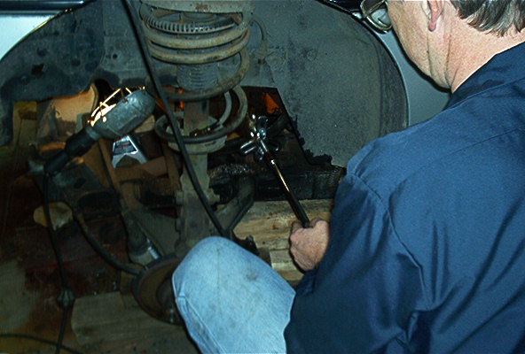

Heres my dad pulling off the Crank gear
Heres the gear almost off

With all the digging I did for that article, I'm glad it helped someone.

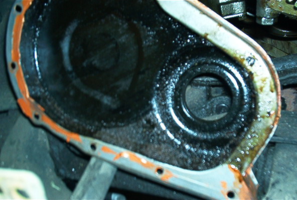

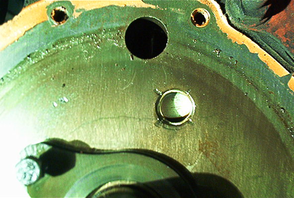

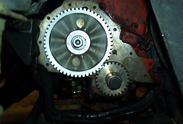

If it's still apart, could you get one more picture? I'd like one with the gears off to point out where the oil galery plug is. It looks like a small freeze plug. I think that's it near the top of the cam gear but can't say for sure.
According to the GM TSB on the gears, the plug is suposed to get a small hole punched in it to improve oil flow to the gears. (size is in the article) That extra bit of oil should improve the life of any type gears used.
(Worst thing that can happen is someone punches a freeze plug instead of the oil plug and has to replace it.... Not dificult but annoying.)
When I get a chance, I'll add a link to this thread to the cave... This should come in really handy for people.

Theogre has the correct way to remove the gear....however I use a shortcut cause I work on commission. I break off the fiber part of the cam gear, being careful not to break the cast iron cam retainer behind the gear.....easy to break. Then I use an air chisel to chisel off the metal sleeve that is left. Not for the faint of heart!!!!! Prob done 50 or more this way, but theogre definitely has the recommended way.

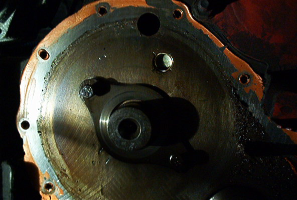

Phil, in the photos above... is that plug that is partly hiding behind the top of the cam gear the oil galery plug GM is talking about in the TSB? Looks like it would about have to be it.

Report this Post03-01-2002 11:23 PM Click Here to See the Profile for Back On HolidaySend a Private Message to Back On HolidayDirect Link to This Post
The Ogre, I purchased a new cam retainer part, and it seems to have several 1mm -2mm holes in it where the original doesn't. i'll take several pics tommorrow for you of that and where the frost plug is, or the area surrounding the area of the cam/crank.

Ogre, I see now about the frost plug, including a close up. Also, check out the cam retainer pics, the old on on the cam still, the new one on the table has holes. Maybe better oiling?

The holes in the retainer are likely to help with the oiling of the retainer area.
I'd say the closup of the plug says that's the oil galery plug. (the lower one that hiding behind the gear... ) Notice how the block has been staked in 4 spots around it... you'd never do that to a frost plug.(I'm not sure if the upper one is another oil passage plug or what... It's not staked as far as I can see. It's in a weird spot...)
Do you still need the hole in the plug with the use of the new style of thrust plate? hard to say. There will be more oil going to the hub area with the new plate, but does it still need the hole? I honestly couldn't tell you.

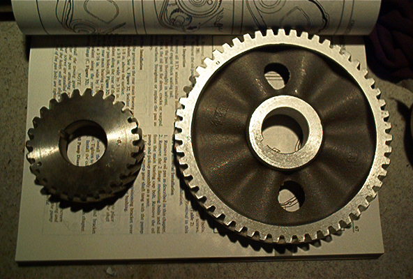

From GM PARTS Counter..
Part Numbers are, new plate for cam and washer: 12508079
Seal for Crank/timing cover: 10243247
Timing gear set (aluminum cam gear and steel crank gear) bought off Carparts.com a division of JCWhitney,
Set, 2.5-R (151) ENG; 1982-86 Alum. Includes 2524 & 2537
• Usually ships in 7 - 10 business days.
MELLING
Part Number: 2538S
Price as of 3/9/02: $35.98
Took about 3 weeks to get from the factory.

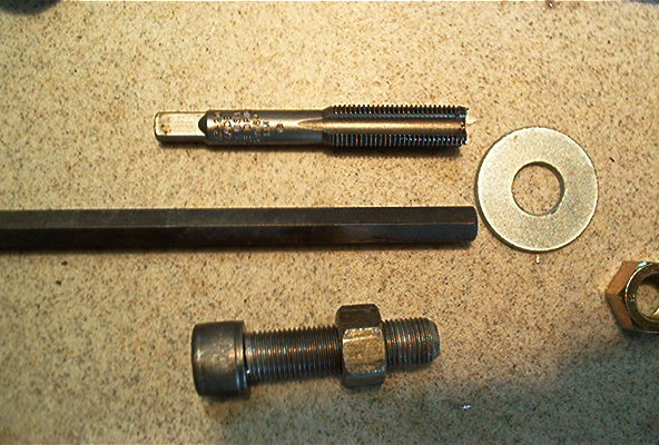

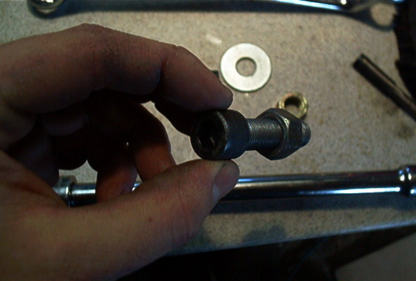

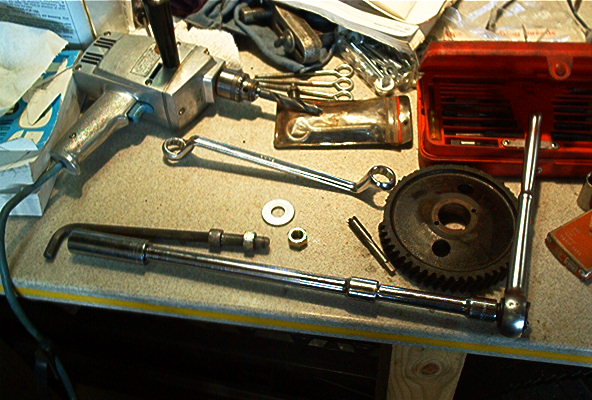

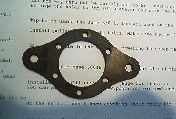

Also, tapping the cam with the 3/8 16 bottoming tap is too small, had to drill and use a 7/16 20 (I believe) but got the gear halfway on and stripped the threads. had to run out and get a 1/2 20 tap and hardware, I recommend using this first as it has more hold, don't even bother with the 7/16 tap, go upto the 1/2 20 it will work better. My dad ground down the tip of the tap to get an extra 1 thread in the cam also.
heres some pics....
next post!

Report this Post03-09-2002 07:57 PM Click Here to See the Profile for Back On HolidaySend a Private Message to Back On HolidayDirect Link to This Post
Back On Holiday
6238 posts
Member since Jul 2001
Pics...
you can see the custom made piece on the center of the Cam gear still, it was dinner time and I only had a minute to flash these cause I was hungry!

BOH, If I didn't already, thanks for posting all this. It confirms/modifies what I have posted and helps allot of people. If I didn't add it already, this thread will be added to the cam stuff in my cave. (hard to keep track of all my changes any more.)

Report this Post03-10-2002 08:48 AM Click Here to See the Profile for Back On HolidaySend a Private Message to Back On HolidayDirect Link to This Post
Thank you, using your info as a guide helped out alot.
Only problem that I had was pushing the gear on, using a piece of threaded rod earlier, when I went back to the hardware store I got a hardened bolt with a allen type connector on the end, make sure its short enough to fit a socket over, since I was using a nut that was 3/4 in size, it almost is an exact fit for a 19mm socket, the socket fit right over the allen head...see pic.
when I tryed using a regular socket wrench also, it would push the gear on crooked, I ended up trying the impact wrench on it, on the low 1 of 3 setting, turned down the compressors output so that it was just giving the wrench a "little" juice, so that it didn't rip the threads. using this way was easyier, but I was really worried I would rip some more threads like I did with the 7/16 ones. part of that resulted in having to switch upto power 2 and tapping the gun, I shouldv'e recharged the tank and used setting 1 more, but if I had to do it next time, go right to the 1/2 20 size.
[This message has been edited by Back On Holiday (edited 03-10-2002).]

Some of the dificulty with pressing the gear may be the gear itself. The center hole may be very slightly tighter than the OE gear.
At least now it's on and we've all got a much better idea of how the procedures work and what to watch out for. Hopefully it will be usefull to others.

Loads of fun, I use a power steering pulley installer, drill a 3/8 hole and in it goes, without heating. Boiling in oil is only for fiber gears (saturates the gear with oil for long life)
