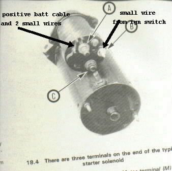

Now dumb question - the large red cable from my battery is the same large red cable that goes to my starter right? I mean is it one piece or does it connect somewhere else in between?

The large red cable on your starter solenoid is the same as the positive cable on your battery. It's one piece and goes straight to the starter. Here is a pic of the starter & solenoid, on my 84 4 cyl with notes to where the wires & + battery cable go.

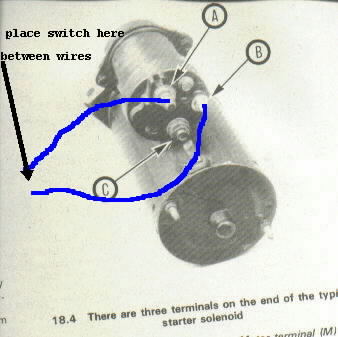

Here is another, showing where you would connect a remote switch if you are feeling unsafe about using the screwdriver across the terminal as suggested above. Be sure to disconnect your batt cable at the batt while you are connecting any wires, for safety. Use goodsized wireing for this, so you are sure you are carrying enough current to do the job. This is for test purposes only, not to leave on the car.

Thanks for the picture!!! It really cleared things up for me. OK now I connected the two posts together and I hear the start making the loud clicking sounds. Like it is trying to turn. Clack Clack.... I also connected my battery to the old starter and watched that turn over fine.
So my battery cable was connected to the starter and I got the clack clack, so I assume the bat cables is good if I can connect the two posts and get a reaction.
The only thing I can assume is that the battery is strong enough to turn the starter a little but not strong enough to turn it when I use the key, since a lot more energy and amps are needed when using the key rather than a direct connection.
Is my reasoning correct?
What I may do tomorrow am is to buy a battery and cable and see if that fixes it.
Another question though. I notices the red cable from the battery has a little cable that connects to something on the side of the engine compartment. Is this somekind of soleniod? I used to have a jeep that had a soleniod there too.... I wonder if that may be bad...if so what is it called?? Should I try replacing that?
Thank you all very much for all your help...I think I am close to getting it, if my tests don't work tomorrow I am going to the mechanic and make it someone elses problem.
