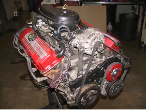

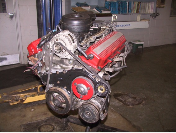

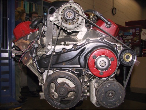

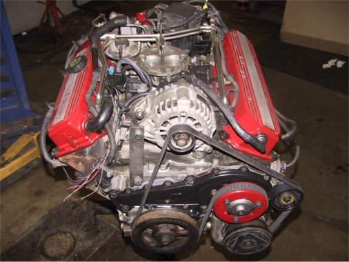

Introducing our Caddy 4.9
fsrowsell
Posts: 145
From: Comox,BC,Canada
Registered: Jul 2000
Report this Post01-29-2002 08:03 PM Click Here to See the Profile for fsrowsellClick Here to visit fsrowsell's HomePageSend a Private Message to fsrowsellDirect Link to This Post
Very nice engine....Keeep us updated with more pictures...

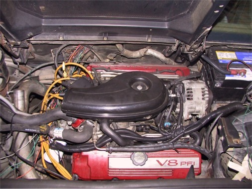

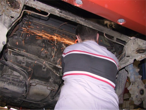

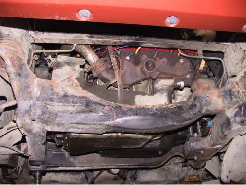

Today I removed the V6 and mounted the V8 in its place, test fit into the engine bay, now to wire and plumb.
My7Fieros
Posts: 3357
From: Germantown, TN
Report this Post01-31-2002 09:59 PM Click Here to See the Profile for My7FierosSend a Private Message to My7FierosDirect Link to This Post
OH HELL YES! Im jealous. Tell us alittle something about where/how/how much about that engine. And more pics!
Alex4mula
Posts: 7410
From: Canton, MI US
Registered: Dec 1999
Total ratings: 153
Report this Post02-01-2002 08:45 AM Click Here to See the Profile for Alex4mulaSend a Private Message to Alex4mulaDirect Link to This Post
Nice! Nice! The only thing I don't like about those engines is that intake snorkel. Looks like for an I4. But who cares with that torque Please give us more details. How about the exhaust? Are you using the 4.9 injection? Fired up already?

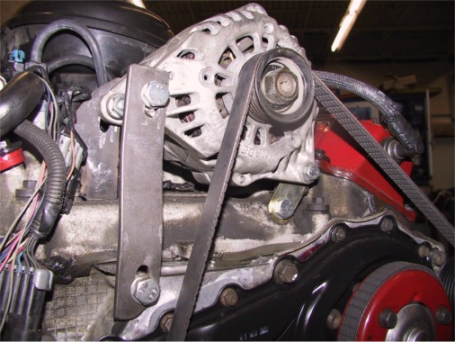

Report this Post02-03-2002 04:26 PM Click Here to See the Profile for PBJSend a Private Message to PBJDirect Link to This Post

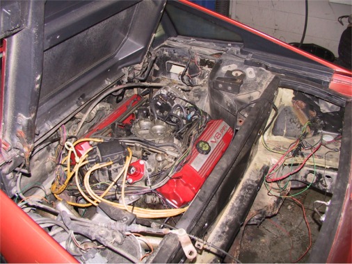

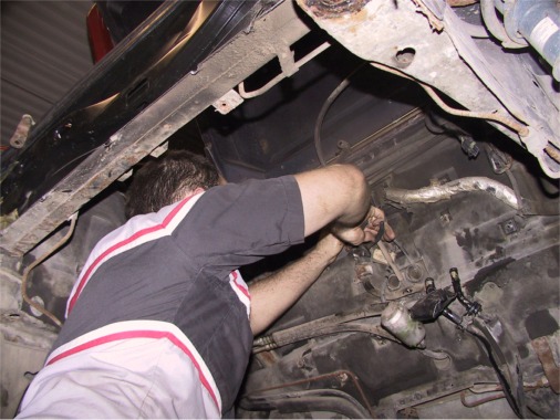

Some pics of it going in:
Mach10
Posts: 7375
Total ratings: 165
Report this Post02-03-2002 05:22 PM Click Here to See the Profile for Mach10Send a Private Message to Mach10Direct Link to This Post
If you would do me a HUGE favor, make some notes about the EFI system going in. That is going to be a huge source of headaches for me
Which auto are you using?

Report this Post02-03-2002 05:50 PM Click Here to See the Profile for PBJSend a Private Message to PBJDirect Link to This Post
I will be using a 1993 seville 4.9 with 85 deville exhaust manifolds and crossover, removed lower trunk for exhaust. ECM is from a 94/95 Deville to run the Caddy PFI. Transmission will be stock 125 auto. The engine is now completely in, cooling system done and filled (with caddy pelets), fuel system done. Remaining work is fine wiring for ecm and exhaust. Passkey bypass circuit built and ready. Exhaust will be from a F body with duals. Motor mounts are my own and will have an upper torque mount.
Mach10
Posts: 7375
Total ratings: 165
Report this Post02-03-2002 06:07 PM Click Here to See the Profile for Mach10Send a Private Message to Mach10Direct Link to This Post
Is the removal of lower trunk a must-do for the 85 manifolds? I am hoping to make the system as "stock" looking as possible, even going as far as custom pipes to the Fiero muffler, and stock tips out...
Is there a clearance problem?
PBJ
Posts: 4167
From: London, On., Canada
Total ratings: 147
Report this Post02-03-2002 06:30 PM Click Here to See the Profile for PBJSend a Private Message to PBJDirect Link to This Post
It's not a must, it's just we thought the lower end of the trunk is so useless, we would use the space for a good exhaust system. To use the factory exhaust, you have to weld an outlet pipe on the crossover pipe. That would be the Bubbajoe way, I choose to do the Rockcrawl way.

Report this Post02-07-2002 08:45 PM Click Here to See the Profile for PBJSend a Private Message to PBJDirect Link to This Post

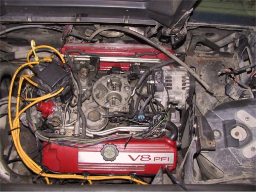

Today, after having an argument with the Passkey II theft system the 4.9 PFI started and ran. Exhaust is in except for the tips. Now for the guage wiring.

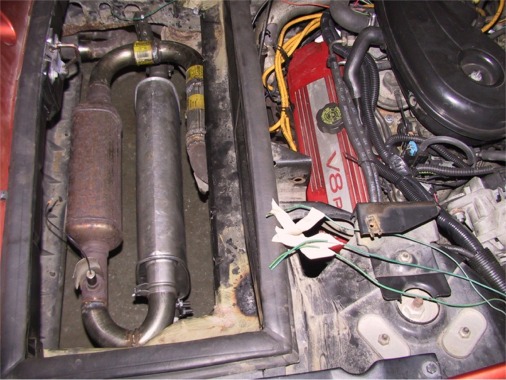

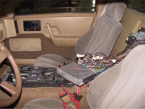

Report this Post02-11-2002 08:41 PM Click Here to See the Profile for PBJSend a Private Message to PBJDirect Link to This Post
More updated pics:
The rockcrawl inspired exhaust(lower trunk removed)
The new look - partially cleaned up - ready for testing and tunning
Still working one wire at a time
