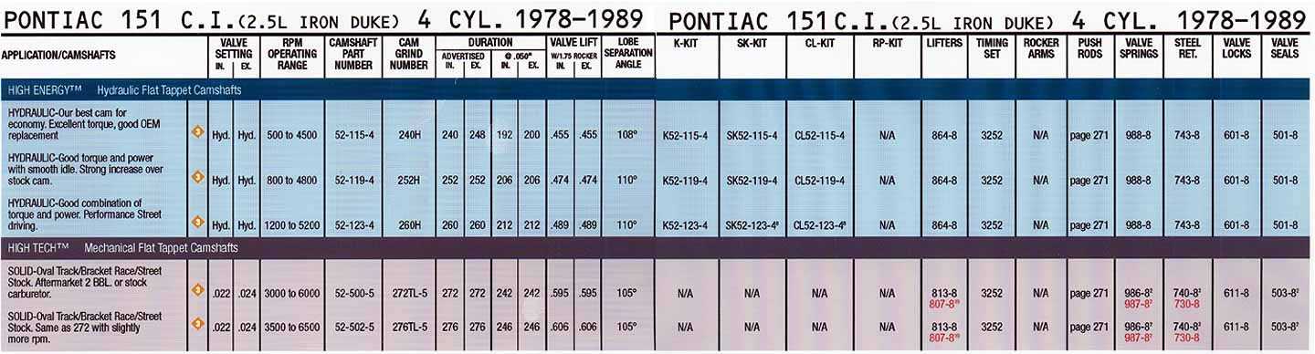

hmm well this might help someone.
Performance rebuild kits are ok but check what parts are included.
List of my planned parts:
Comp cam 1200-5200rpm cam (Just realized this was wrong )
Lunati roller rockers 1.7
specialty 5.9" connecting rods
.030 over bore hyperuetic pistons
chrome molly rings
Custom head work to open up the oil flow
high flow oil pump
custom machined SD crank (machinist resized it to fit the block and rebalanced it)
Billet timing gear assempbly (from a friend)
Custom made intake manifold with 4 barrel carburator setup.
hooker header
thats about it for now. Still having problems aquiring certain parts. Estimated HP if the math was accurate is around 190-215hp. Never done that myself so don't know how high it will go.

Someone suggested I goto a company (sorry but I wont name the company) to get graphite coated coppergaskets. Having never heard of these I thought that'd be kool and the descriptions sounded great, but the POS company kept screwing me. so we wont go there
Right now I'm trying to find better gaskets. Chrome Molly rings are great for pistons, too bad ya cant get similar for everything else. Might try to use a SD gasket from GM and modify it a little. Someone suggested gasket coating the OEM style gaskets insert? but there again is something I'm not familiar with.
Word of advice, if you have the head off the block and can get it cleaned profesionally after modifying it, or can get someone to do everything for you. Go to a junkyard and look at the head from a 91 grand am. probably any similar year of U code tech will be the same. Around the lifter rods theres a little bit of Iron but theres alot thats removed for better oil flow. I'm having my heads reworked to match or semi match that design. Makes head weigh less plus enables for better cooling. just dont get too carried away with it.
also, I don't recommend going over .040 on a bore. .030 should be fine. If you go with 5.7" connecting rods I THINK (check before trying this though) you can run domed pistons. flat pistons will work with 6" since I think thats stock height. you can run specialty 6.1" or 6.2" if you use reverse domed pistons or recessed, butyou have to be carefull with those because theyre not as strong, also your more likely to tap a valve. Was talking to a race mechanic and he said try polishing out the intake valves and maybe enlargening them by up to .008 for better flow, but don't do anything except maybe polish the exhaust. Have never tried this but it might be possible.
Another thing I found out. You CAN use the turbo assembly from either the Thunderquack or the grand am 2L turbo. either applications needs minor modification if you know what to do. And no I don't otherwise I would have already.
If you run Nitros or turno on a duke modified the way i want to, you shouldnt see the problems you would if you do it to an OEM setup. the Hyperuetice pistons and the chrome Molly rings both love higher RPMs and can handle more pressure in the chamber. But still be carefull.

Sorry I didn't respond to this.
As for as I know, you can go through Napa or maybe JCwhitney for a "performance" rebuild kit for $175. Now I don't know if I recommend JCwhitney, but I have used the rebuild from NAPA with a.020 oversized piston set. Engine stayed stock except for the oversied pistons. On 91 grand Am that was getting 36 mpg when new and after 100,000 was down to 23 mpg, the rebuild put me up to 34 and was easier to spin the tires. mostly just felt more torque stear.
Crank, cam, rods, lifters are all special order items. I still suggest Comp Cams:
I'm going with #52-123-4 The last one in the street category. I also prefer lunati over Crane roller rockers, dont knw why though lol
As for shops, ask around and find someone thats reputable. Don't be afraid to go over there and just check things out and maybe ask if they have much experience with 2.5Ls. some do some don't. If they do, or least theyre willing to work on them, see if they can help with custom mods. they may know someone that can perform the machine work. it took me 5 different shops and three referals to find someone to shave some off the SD crank and rebalance it. Even harder to find specialty rods at 5.9"
Best thing is to ask around. Find out who does what and whos recomended for what.
