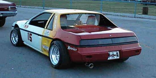

Here is a photo of me (with my 13x10's) at the strip behind a Dart with big wrinkle slicks (I beat him anyway with my little 4 banger!!).

Report this Post01-02-2002 10:20 PM Click Here to See the Profile for cadero2dmaxSend a Private Message to cadero2dmaxDirect Link to This Post
cadero2dmax
1266 posts
Member since Oct 2001
OOoops, that photo was taken when I was running 15x10's on the rear.
But my philosophy stays the same - I have run 13 x 10 road racing slicks at the strip with equal success - still mid 13's with a normally aspirated Q4.
G

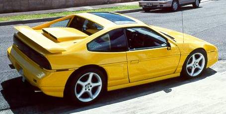

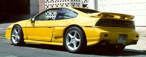

O.K. Here's my first try at posting a pic...

Mr. Farknocker -----that is a beautiful car . Very nice job , just beautiful. Who makes the scoop , and wheels ????????? welcome to the forum GT GT 87
