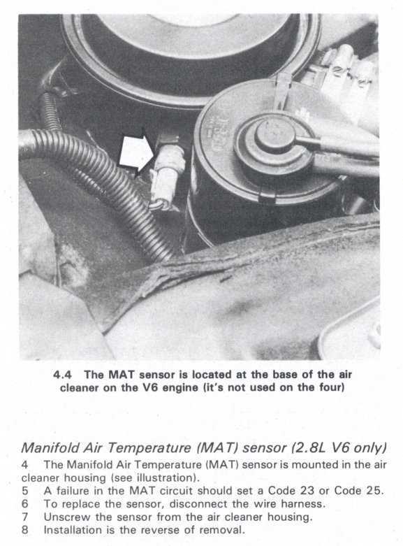

We think that we have found the problem to be the MAP or MAT sensor. However; my machanic can not find the location of the MAT sensor. Does anyone know where it is?

Here:
Next to the vapor canister on the opposite side from the battery (under the louvered vent.)
