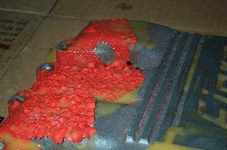

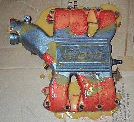

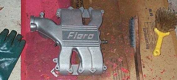

Thanks to all the people who suggested that I use this.
This stuff rocks! I put it on the plenum and waited about half an hour and every part of the paint it touched came off.
I also heard that it's not even paint but an epoxy baked on at the factory.
Notice the heavy duty chem golves and the wire brush. The aircraft stripper was so strong that it started making the fingers on the glove soft.
You can't see them but I was also wearing saftey glasses. I can't even imagine if that stuff got in my eyes.

I got the tiniest speck of paint that was stripped off on my forearm and started to feel this burning sensation. I realized inmediatly what it was and rushed to the sink to wash it off. That stuff really is brutal.

Looks like that stuff works REAL good!
