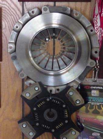

Some clutches do require more of a break in period than 100 miles. The CForce I use requires 400-450 miles of NORMAL driving. FYI, your clutch should not be slipping at all. Slipping is not a normal function of the breakin on a clutch. You don't just drive a new clutch letting it slip like you describe. and then all of a sudden when you put XXX number of slipping miles on it, the slipping stops and the clutch is wonderful.
I hope I've explained this enough.
When you put in a new clutch you drive it normal for a given period of time. If it's slipping during this period of time then your doing something wrong. You just don't drive it around for 500 miles or so and all of a sudden it starts working like it should. You've most likely made toast out of that clutch already....... start making plans for the next one.
