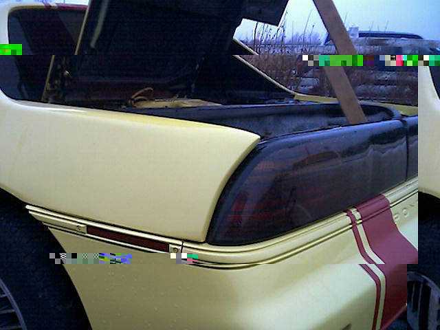

Report this Post11-30-2001 07:51 PM Click Here to See the Profile for jimmybpeiSend a Private Message to jimmybpeiDirect Link to This Post
THIS IS THE ONLY PIC I HAVE RITE NOW
DOSN'T SHOW THE WORK DONE INSIDE. WILL POST SOME PICS OF THAT TOMMORROW
lATER
JIMMY B.

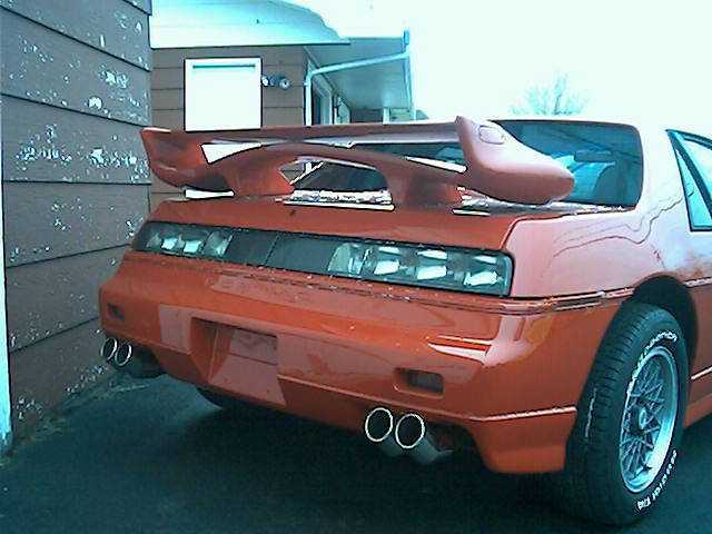

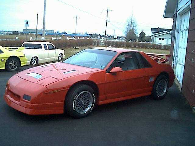

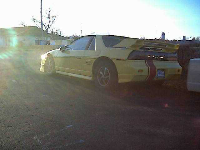

Report this Post11-30-2001 09:00 PM Click Here to See the Profile for jimmybpeiSend a Private Message to jimmybpeiDirect Link to This Post
these are not that great, car goes in the garage under the knife dec 1 the 17" are off being painted for the caddy car, paint is bad ect ect..
the caddy car no 17" s yet tho
later
Jimmy B.

really not that much work. first i just cut the rear quaters off and then ground the quaters about 6" to foot back and then made a shapped template to lay inside the quaters to hold the fiberglas in place whil it set up.
Then i cut the quaters to length and started shaping them. Once that wa done i fitted the tails in. had to make a new mounting bracket to hold them into place.
Than it was onto extending the trunk and fitting that.
i did this car about 6 years ago and the quaters havent cracked yet. i usually keep the trunk closed at car shows 'cause it dosn't look too pretty in there. Will take some pics today and post them.

How'd you do the covers over the front signals? I like!!!!

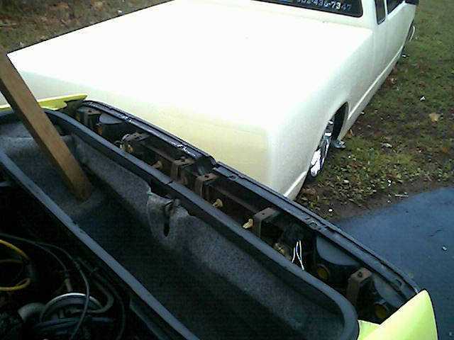

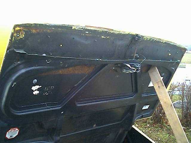

OK guys here are a few pics of the inside of the trunk. Carfull thay arn't too pretty, i may try to finish up this winter if time permits.
Thats about as good as ican show it.
