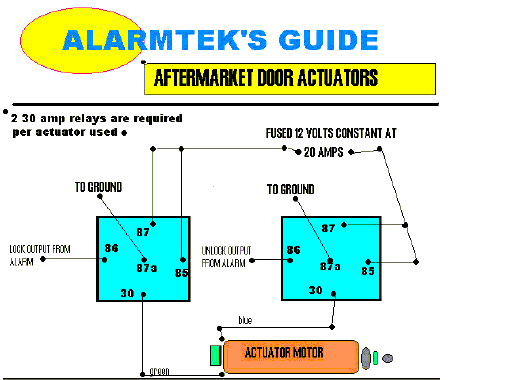

I used the search function, but couldn't find the info I'm looking for. My door lock actuators have two wires running from them. Any Ideas?

Here you go:

Yeppers, you require some relays.... Here is the diagram...
