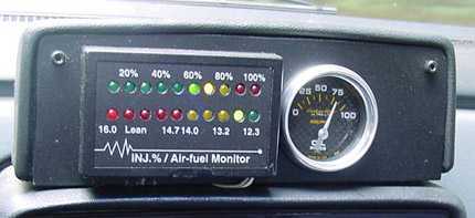

i like my haltech unit. air/fuel and injector duty cycle. bit over $100 shipped.
mine working.. the car was cold so it's slow to react.. but within 2 minutes of the car running it's reading juuust fine... if you get a heated O2 it'll read quicker and the car will respond faster when cold... but thats not real a must.
http://www.1fst2m6.com/images/1fstmonitorrunning.MPG

lol.. yep..it's an aiwa.. i needed somthing cause i sssent my ssssony in to sssstop the ssssskiping... it's CDX-C910.
make your own? nope.. it'll take me 8-10 hours to make one or for $100 i can go buy one... is your time worth $10/hr? i just have one to make sure i'm not gunna destroy the engine under spray.. the apexi has 2 settings, n/a and switched (nitrous) it pulls 85% injector duty n/a and 72% under spray thats WITH 19lb/hr injectors. the a/f ratio is 12.8 n/a and stupid rich spraying those #s from the Competition Data systems logging equipment at EP. and their within 5% on the haltech.
