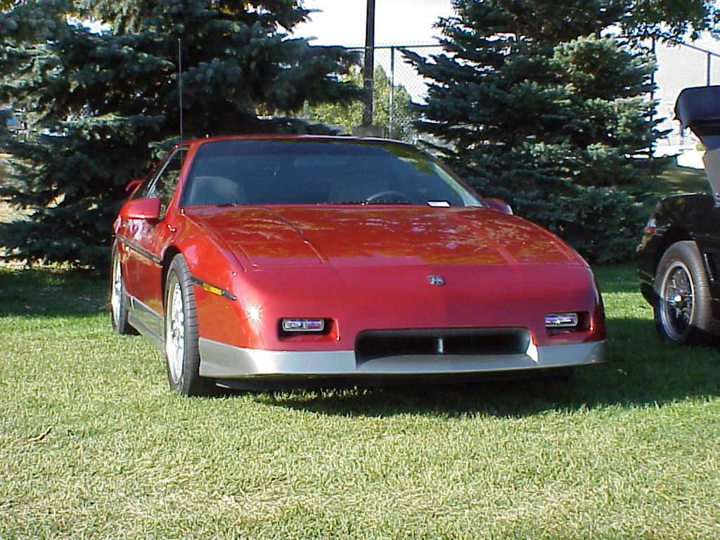

Since we're talking clear running lamps now, let's look at the obvious...
Lawrence's setup looks cool, but if you're wanting something brighter (and it looks like you're going with clear)
Buy some $40 driving lamps from AutoZone and wire them to your ignition. This is exactly what you're looking for, if I understand this thread.
Hope this helps...

Photoshop rendering of planned exterior modifications.
fierosound
Posts: 15253
From: Calgary, Canada
Total ratings: 286
Report this Post10-30-2001 09:44 PM Click Here to See the Profile for fierosoundClick Here to visit fierosound's HomePageSend a Private Message to fierosoundDirect Link to This Post
These are "twin lamp" driving lights. I replaced one of the halogen bulbs with an amber signal bulb. I've wired a GM DRL module to provide 1/2 voltage to the halogen diving lamp. They get full power only when driving using high beams. Super Bright!!!
