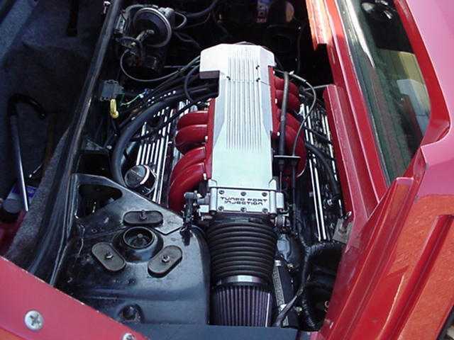

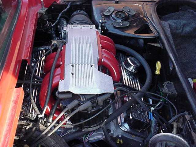

Unlike all other Fiero engine swaps, changing the plugs on a SBC swap is real easy from underneath.
As you can see in this pic., all of the plugs are easily seen and are easy to get to.

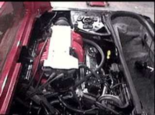

Day #4… 9-14-01 continued
Continuing with day #4

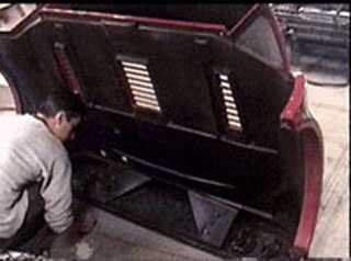

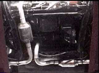

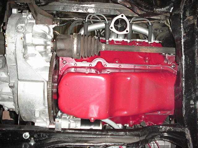

I've had a little problem with the disc that had the stills from my digital camera, so these pics are captured from the Video tape we did of the swap.
We managed to get a lot done on this day, our goal to fire the unit up on the 5th day appears to be intact.
We continue with the assembly by installing the modified Fiero wire harness and integrating it with the aftermarket TPI wire harness.
We install the TPI ECM in the trunk area behind the carpet. Our Video instruction take takes the wiring for the Carbed engine or the Fuel injected engines in great detail. The pics are captured from the new video instruction tape that we recorded while doing this swap.
The Video tells you what to do with each and everyone of these wires and more. It's not as complicated as you might think.

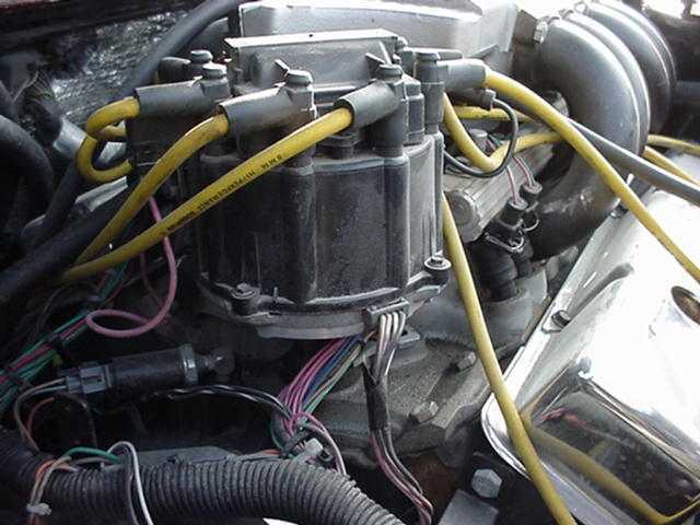

Here we have installed the fuel rails, injectors & distributer. We've run the TPI wires under the fuel rails to the injectors and TPS, IAC & WT sensors.
Then we can install the TPI tubes and then the top part of the TPI air box
On day 5 we will complete this installation far enough that we can fire the unit up.
See you then

Here we have installed the fuel rails, injectors & distributer. We've run the TPI wires under the fuel rails to the injectors and TPS, IAC & WT sensors....
Archie
Hey Archie,
Is there any way to get a better shot of the "under the plenum" wiring route that you use? I'm installing a TPI into my 68 Camaro and would love to hide the wiring a little better.

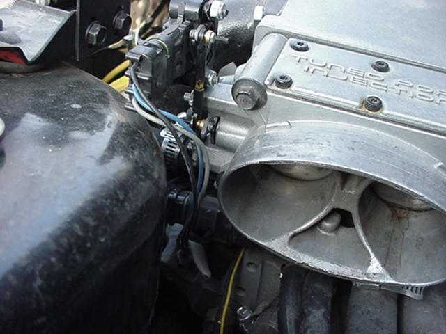

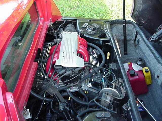

Day #5… 9-18-01
Day #5 now we are heading quickly towards starting this unit up for the 1st time.
Install the Throttle Body, tighten the bolts on the TPI tubes, install dist Cap, route the plug wires etc.
At this point we are also installing the W/P drive for the last time and making all the connections for the cooling system. We also get underneath the car and build up the exhaust system
Well, finally…. It's time….. I know you can't hear it but we've finished the connection of everything and this view is just a few seconds after the engine was fired up for the 1st time. This is the last view of the engine in the car before we reinstall the rear clip.
Now we can install the rear clip and take her for the maiden voyage. I've been doing this full time for more than 15 years and have installed around 170 V-8 engines in Fieros and this is the most exciting time on each and every car. I never get over the thrill of the first test drive, and this one will be no different.
Tomorrow is the last day of this swap and we button things up a bit, do a bunch of test driving and send Mr. Rutz out for the ultimate test drive from Chicago to Napa, CA.
Tomorrow we also get back to using the good quality digital pics.
Archie

Wrap up a few things, connect the cruse control…. Drive it around a little while. Inspect for any leaks etc. Drive it some more etc.
One nice thing on this swap is that the customer was there for all the important parts of the swap and he was also there to assist in the Test Driving. You will recall that he has owned this car for more than 10 years, so we had to teach him how to drive the car again, hehe.
As you can see the engine and the car both look pretty good.
Any more questions? Just ask away.

Roy, let me see if I can help you a litle with TPI wire routing. I don't really have any good digital pics. of the wires on the intake before the air box is installed I have a bunch of video tape of that but pulling pics off of video doesn't produce a very detailed picture. So, I went out and took some pics for you today.
You can see the wire harness (just to the right of the Dist.) as it goes past the dist. and under the fuel rail. You can also see a couple of the injector wires as they come over the fuel rails on the right side and attach to the injectors. the wires that run under the air box are as follows.... 8 sets of injector wires (4 of them stay to the right and the other 4 go to the left) also the TPS, IAC, ATS (Air Temp. Sensor), and the Water Temp Sensor wires go thru here too and on out under the Throttle Body to attach to the proper sensors on the front of the base lower intake manifold as you can see a few of them in this pic.
I hope this helps

Archie.. What headers are you using, I would like to get the PN if you have it. Looks much better than the Ram Horns. TIA
pherder
Posts: 925
From: Sedgwick, KS
Registered: Aug 99
Report this Post11-09-2001 10:55 PM Click Here to See the Profile for pherderSend a Private Message to pherderDirect Link to This Post
They are Sanderson CC90 headers.
Best price I have found to date is at:
