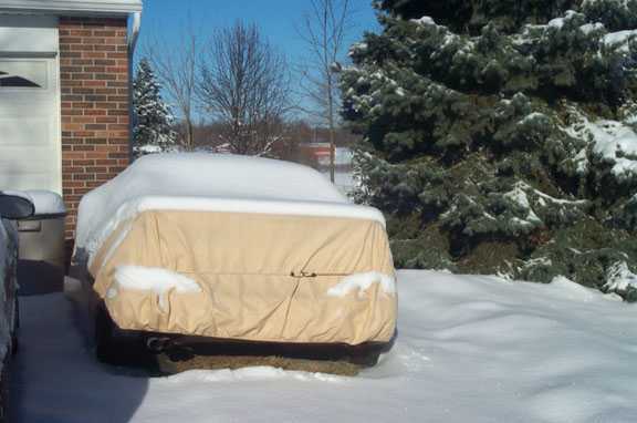

Mine get put under wraps. Usually a tarp goes over the car cover. Pull the battery out. Some time the juice seems to drain out over the winter.

I fill up the tank and mix in STABIL, this keeps the gas from going bad. I also change the oil and disconnect the battery. Then I throw a good quality car cover on the car and leave it alone for spring.
For those of you who don't have inside storage, why don't you rent a storage unit? I've got a 10'x20' unit and pay $66/month. Most of the time you rent on a month by month basis.
