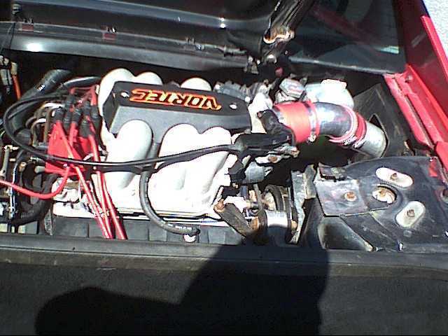

Are you talking about the 4.3l Vortec engine like this?

Im not sure. It is the turbocharged engine found in a typhoon/syclone. Im not sure if its a vortec or not. I dont know what it looks like.

The sy/ty motor isn't the same as a vortec. The vortec is a different style of intake/injection. It uses a central port injector with six hoses running to poppet valves for each cylinder.
I don't think the vortec was a standard deal until about 94-ish, where as the sy/ty turbo motor was out before that.
