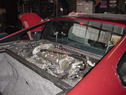

In case you're wondering about the 4G63 (2.0L DSM turbo engine) engine in a Fiero, take a look:
Also visit http://www.buschurracing.com Mid 9's out of a 4 cylinder turbo.

Is it me or is that Mitsu motor in 180 degrees the wrong way? I could be wrong.

No it appears to be in the right way. Notice the Fuel Injection/intake manifold in the rear of the engine. The exhaust comes off the front and wraps around the bottom of the motor to go around back.

The swap is still in progress. It's a friend's project that he's been working on for a while. I'm helping where I can.
It's by no means done or even running yet. There's still a lot of work left to do.
The engine is 180 degress to what everyone's used to. The transmission is on the PASSENGER side. It uses a DSM FWD tranny.
As far as "settling" for the DSM engine over the Toyota engine, I think you'd be better off with the DSM engine. More of them available, more reliable, easier to get more power out of, and a lot of modifications available.
