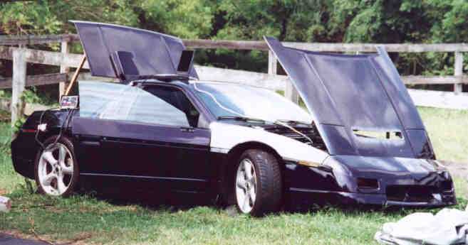

looking to see how much extra a v8 is goin to weigh????
My yellow car weighted in at 2860 with me in it a couple of years ago
v8 install is going goo ready to put the motor in on mon or tue as sooon as the mounts get here all thats left is the wireing ad the exhaust. piece of cake rite??
things are going about as good as could be expected i guess. It's really not as big of a job as i thought it would be and i cant get you any more pics than what bubba joexx
has on his site, he's got lots
Later
jimmy B.

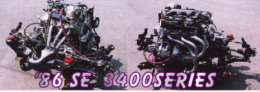

Not that you mentioned it, but the 3400series V6 is at least 50lbs lighter than the 2.8.
Did you get your car in my book yet????
http://www.animatedconcepts.com/fierobook.htm
KissMySSFiero
Posts: 5559
From: Tarpon Springs, FL USA
Feedback score:    (18)
Total ratings: 111
Report this Post09-16-2001 10:51 AM Click Here to See the Profile for KissMySSFieroSend a Private Message to KissMySSFieroDirect Link to This Post
how is it lighter? a few pounds i might see, but 50 seems high. its the same block and heads just different bore and stoke i thought?

The 3400 engine has aluminum heads, which makes it lighter.

The 3400 is a FWD block. I wouldn't use the stock Fiero intake... too restrictive. The Aluminum GenIII heads have larger valves than all the others, fast-burn heart shaped chambers and you can pick them up with one finger. The intake has larger ports. I did have to engineer a few parts to put it in.
Some creative scoop/vent work is necesssary on the deck lid unless you want to relocate the alternator.
Desktop Dyno says 300hp. Too bad I'm going to have 200lbs of stereo.
