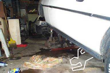

Report this Post08-29-2001 03:55 PM Click Here to See the Profile for 84BillClick Here to visit 84Bill's HomePageSend a Private Message to 84BillDirect Link to This Post
Breaker bar on a ratchet I broke my ratchet.

84Bill... That pic looks like a crime scene photo
TONY_C
where's the chalk outline of the body?....
OcalaFiero
Posts: 152
From: Ocala, Florida, USA
Report this Post08-29-2001 04:41 PM Click Here to See the Profile for OcalaFieroSend a Private Message to OcalaFieroDirect Link to This Post
Be careful what you ask for, I must have too much time on my hands...

84Bill
Posts: 21085
Total ratings: 461
Report this Post08-30-2001 07:42 AM Click Here to See the Profile for 84BillClick Here to visit 84Bill's HomePageSend a Private Message to 84BillDirect Link to This Post
LOL!! crimescene, never looked at it quite like that

fierohoho
Posts: 3494
From: Corner of No and Where
Total ratings: 221
Report this Post08-30-2001 11:07 AM Click Here to See the Profile for fierohohoSend a Private Message to fierohohoDirect Link to This Post
Usually in a photo like that you see at least a couple of dead soldiers (beer cans)
all I see are two dead cans of WD40.
Tell me thats not a pair of your underwear on the floor.
