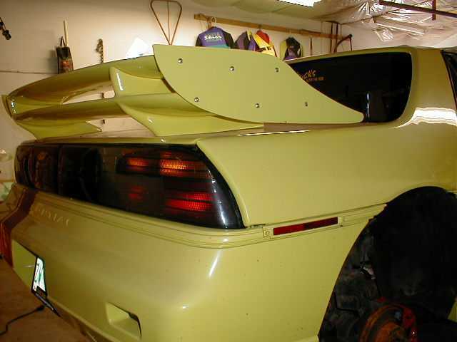

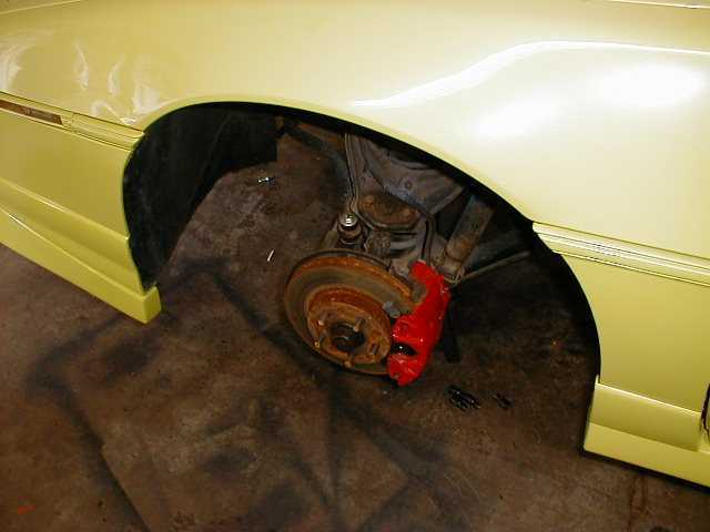

JimmyB is a very talented and creative young man with cars and trucks. (He built a Chevy S-10 show truck that a rabbit couldn't get under and had reversed hinged doors.) We were lucky enough to meet him in our recent trip through New England and the maritime provinces. We stopped at two junkyards asking for Fiero parts on Prince Edward Island and both places told of this guy with Fieros in Summerside. Well, we tracked him down and were pleasantly rewarded with cool Fieros and a very nice guy. He was kind enough to allow me to take pics of his work. Please realize we visited unannounced so he was working on the car and would be even more awesome with the wheels on. He had cool 17" wheels. Note the great job he did putting inexpensive Grand Am vented brakes on his car, both front and rear. So here are the pics he was referring to. I am sure you will enjoy the clever work too.
Notice his front turn signal blackout covers. Very nice touch.

Wow! Very nice work. Looks stock. Eventhough we know it isn't. I like it a lot. Good job.

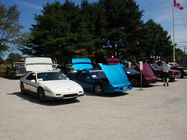

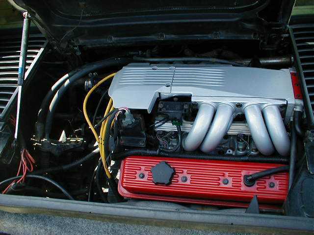

Hey Jelly 2M8 are we going to get a visit from you next weekend? I need to know what parts you wanted specifically so I could try to get them here in time. Looking forward to your visit. BTW this is another clever Fiero guy way up in Nova Scotia if anyone needs work done he has a service garage which specializes in Fieros. Check this out.
Three of his cars, Left 2M8, Center V6 notchback, Right V6 notchback converted to GT which he let me drive to the show. (Thanks, he let me drive the 2M8 too. WOW!)
The engine of the 2M8

saleen wing? any modification there? that might be nice on a gt, or is it the same wing c.m. west posted on a black gt? mustang wings just seem to work well on fieros.

philphine- the wing is off a saleen mustang, i saw the wing in daytona back in 97 on a mustang and got home and started measuring.
perfect size except for the stands they had a bump that had to be sanded off. the wing came directly from saleen in calf.
