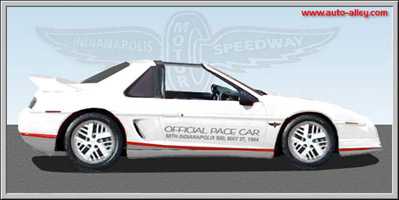

No, the Indy just has a sunroof. I have 4 more Fieros besides it, including an 88 T-top coupe that I am planning to convert to a modified 3800SC T-topped Indy clone. With some of your ideas and some of Aus's body panels I hope it can be a really cool car.
I did a mock up of the dream in Photoshop and then the AusMaster did it even better for me. It will definitely have Aus side panels but I'll be watching you for more ideas for the rest of the car.
