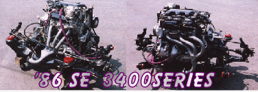

They sure do. Aside from the iron head 3.4 they make the 3400. I've got one. Some fabrication needs to be done. I will be posting pics of my conversion soon.
I only know of one other...Steve.

The 3400 will not look like a 2.8. You have to use the intake/valve covers/throttle body/DIS from the 3400. If you want a list of parts, I have been compiling an Excel spreadsheet of the different parts for the swap.

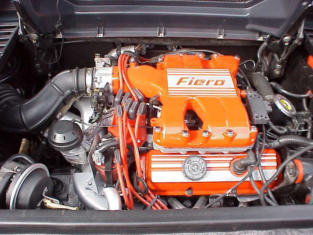

http://www.geocities.com/calgaryfieros/tonys87.htm
Pontiac Transport FWD 3400 roller-cam block, Fiero heads and top-end. Looks stock, works great!!
