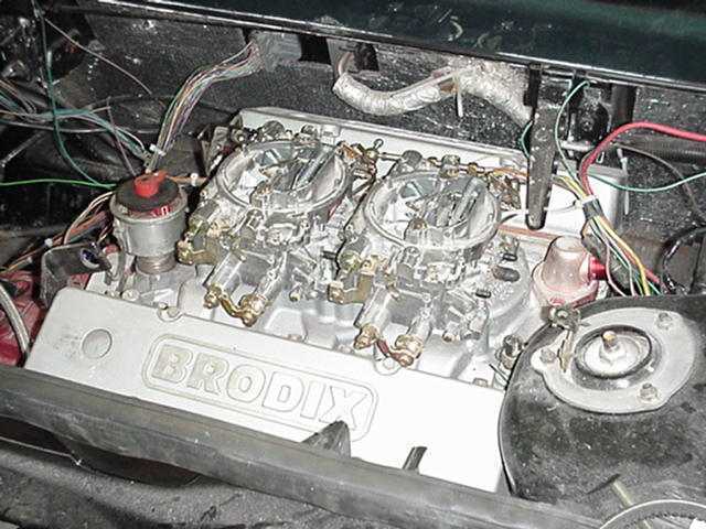

Archie
Posts: 9436
From: Las Vegas, NV
Registered: Dec 1999
Total ratings: 547
Report this Post08-01-2001 01:47 PM Click Here to See the Profile for ArchieClick Here to visit Archie's HomePageSend a Private Message to ArchieDirect Link to This Post
Dual Quads.

Report this Post08-01-2001 02:32 PM Click Here to See the Profile for sloth85GTSend a Private Message to sloth85GTDirect Link to This Post
Ahhhhhhhh there's the man I want to talk to!
Hey Archie, wassaaaaaap!
You're THE V8 Archie right? If not, then these questions won't apply. How much are your kits for an 85GT? What's the cost to ship to Winnipeg Manitoba? What will I need that your kit does not include? Any advice about the V8's as well would be appreciated.
P.S. v8archie.com RULES!!!!!!!!!!!!
