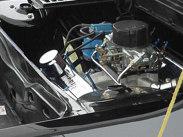

Now, at the Carlisle show I took a bunch of pics. of the Hi-Tech cars they had there on display. I think you'll find this pretty interesting.
!st go to the Hi-Tech site http://www.hi-techdev.com/htdv8.htm and read the following statement "The HTD Eliminator Fiero - V8 Installation Kit will mount any Chevy V8 in your Fiero. Many V8 engines can be installed with no body modifications, as in the one pictured above and throughout this Web site."
Now, look at the pictures I took...

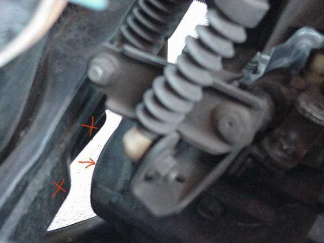

See that red X That is the frame rail on the left side.... right below the X you can see the transmission sticking into that frame rail.
They have the transmission so deep into the frame rail that they even had to notch the rail to clear the shift linkage.
Nice shot looking across the engine towards the left side of the engine compartment. What is that just to the left of the distributor cap? Is that daylight you see thru the wheel well opening? Did they cut out the sheetmetal of the inner wheel well? YOU BET THEY DID!!

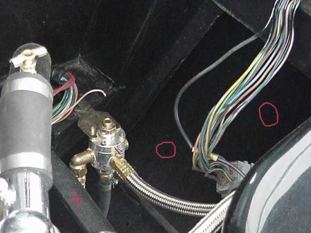

Over on the right side now. The red X, That's the top of the frame rail. The arrow points to the TIRE. The green stuff, that's grass where there used to be inner wheel well sheet metal.
Another picture, that's the right side frame rail where the X is. The "0"'s ? that's the inside of the plastic Fiero quarter panel.
Now does that little bit of sheet metal as described by V8Fiero above really matter that much when these guys are doing all this cutting?
As you can see, what's advertized on the web site and what you actually get are not always the same.

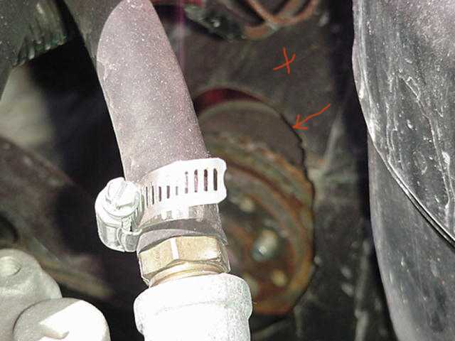

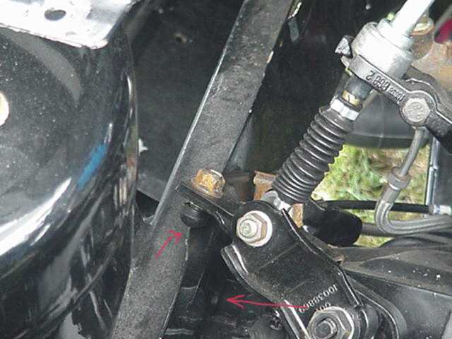

This pic. shows the stock left side frame rail "X" for a 87 Fiero coupe and the arrow shows the left end of the transmission. That daylight you see between them proves that the trans. doesn't violate the frame rail.

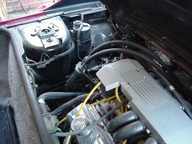

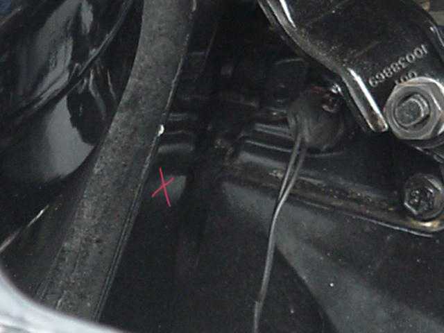

Shot looking across the engine towards the left side of the engine compartment. All you can see here is the stock sheet metal in the wheelwell & THAT'S GOOD.

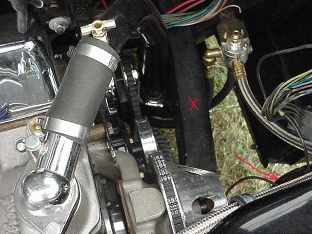

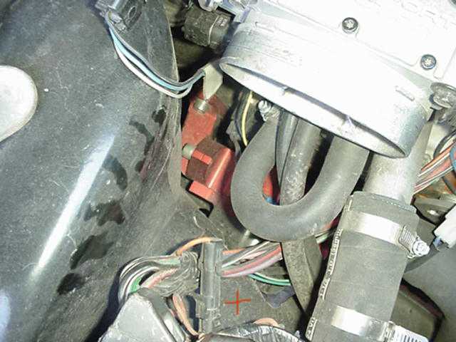

Over on the right side now. The red X, That's the top of the frame rail. The "O"'s show the sheet metal that was missing on the HDT pics.

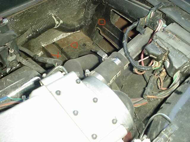

This is a shot of my belt drive W/P setup. The "X" is the stock sheet metal. The arrow shows were a 3" Dia. hole is cut in the sheet metal for the W/P Drive.

Any more questions?
