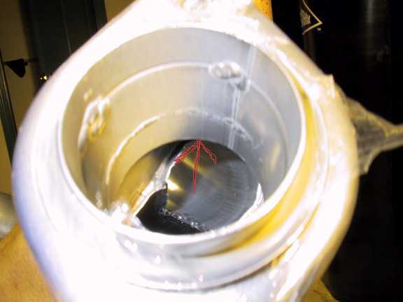

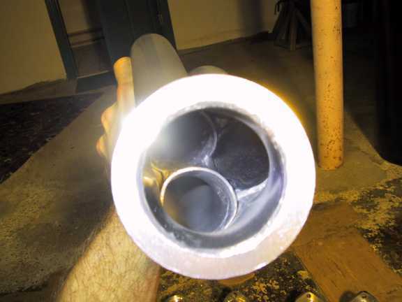

The crossover pipe collector has a flange welded into the opening that has metal that protrudes into the inside of the pipe. This protrusion of metal or flange will cause turbulence in the collector reducing flow. The front header pipe collector has one runner that sticks slightly into the collector partly blocking off the flow from the other runners.

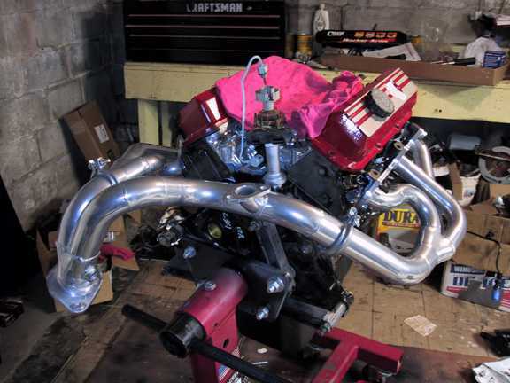

Here are some pictures of the headers. This is a picture of the crossover collector that has the metal flange protruding into the collector. See red arrow.
This is the runner that intrudes into the path of the other runners in the rear header. It's hard to tell in the picture but it's there. You can also see the uncoated runner in to top right and see the rust if you look close.

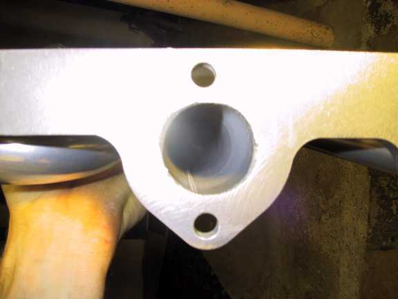

The flanges are nice and thick and the openings are nice and large.

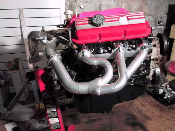

The headers went together without any problems and they fit very well.

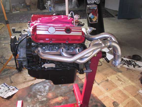

The front of the header or firewall side.
The rear or trunk side.

this will not create turbulance as these 3 pipes are going into a larger opening, however you will find problems if you have a manual transmission as the shift cables ( or shift cable if you have a 5 speed ) sit on the y-tube, this can be corrected with a dimple formed on the Y-tube by heating it with a torch and formed with the tube laying on a firm, hard surface so it does not distort where the flanges meet the manifolds

Chris West your right about that firewall collector but the one for the crossover pipe will because the flange piping sticks into the pipe opening about 3/8".
