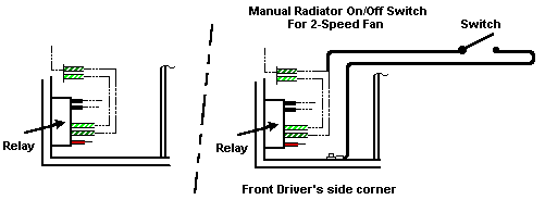

I just did this to mine this weekend, same 2 speed fan. Here's a schematic of what I did.
Grounding the dark green w/white stripe wire triggers high speed, and the light green triggers low speed. I set mine up for high speed with the switch. I believe you can wire the switch inside the car if you can locate the wires under the dash. If you leave the manual switch on and turn the car off, the fan will automatically turn off.

Cool thanks for the pic.
I have been wanting to do this for a long time.
