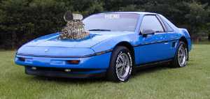

How about a Hemi?

Is that the rare twin engine 4WD fiero I have been hearing about?

LOL Now aint that da sheet!

Spidyfoot, is that really a Hemi in a fiero?
