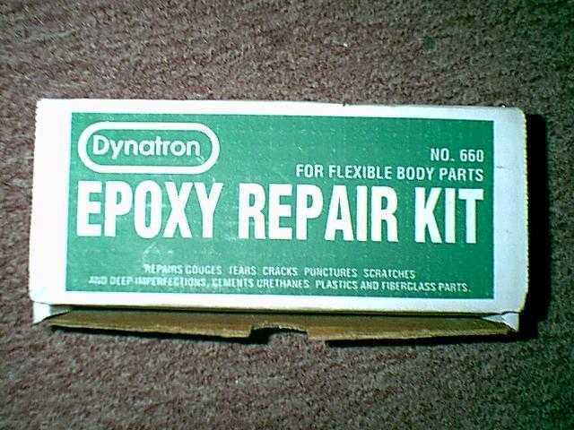

I found this stuff at autozone. It is a 2 part epoxy. It worked great on my bumper.
Here is a pic.
Josh
