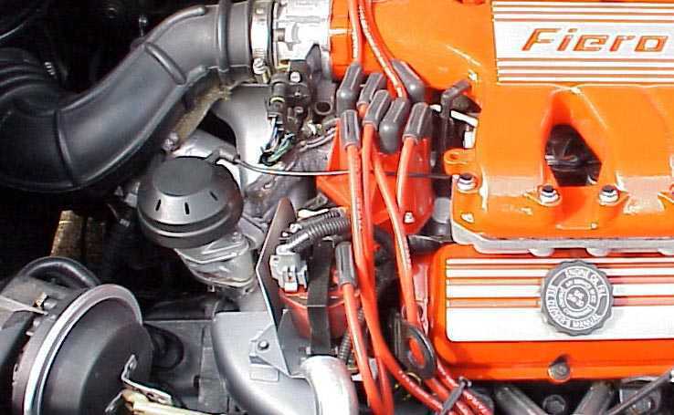

I got this from an Olds Cutlass Ciera at a wrecker. Should be fairly cheap even from GM. I didn't see them on any other cars other than the Olds though...

That is a pretty engine. How about more picture of the engine and car. I heard about the EGR cover but that is the first one I saw. Thanks

Now I remember, you are the one with the awesome engine. No wonder the posted picture looks great. I read your post many times on what you did to that engine. How has it been doing? Have you ever had it on a dyno after being completed. I think this is the first I saw your car instead of just the engine. Very nice definitely post more pictures.

Fierosound, what kind of wires are those? And where can I get a pair? I was planning on getting the blue Splitfire 8mm from the Fiero Store but blue will not match my valve covers and intake manifold Are those 7.5mm or 8mm?

RED Plug Wires - TAYLOR Vertex Pro Series - #074224 Spiro-Pro Custom 6-cyl red http://www.taylorvertex.com/spark.html#spiro
RED Dis Cap & rotor - WELLS PROFESSIONAL GOLD #DR2012G
RED Ignition Coil - HOLLEY Annihilator Coil - #820-214 - Lasershot Street Inductive http://www.weiand.com/HiOctn/ProdLine/Products/IS/ISLSC/820-214.html

Cool! I'm gonna have to get one of those covers. My EGR valve looks like it crawled out of the ocean.
Nice job on the engine!

Is there a GM p/n on the EGR cover?

SWEET MOTHER OF GOD, FIEROSOUND!!!!! That powerplant is gorgeous!!!!!
There's a lot of good-looking silver paint on that engine. I checked out the "Details" section on your site but didn't see it listed. What did you use?

Looking inside the cover I see a PN# 69228.
I don't know if that is any "correct" Part Number, but you may want to check it out.

Just to let everyone know. GM Discontinued that part in May of '99. Dealers price was $14.10, with list price being $23.50. The GM number for this part was 17069228. Call your local dealer, maybe they have one sittin under an inch of dust on a shelf in back. Also for everyone FYI... It was also used on '89 Firebird w/3.8 eng., '88-'89 Bonniviles, '85-'88 Buick Somerset and Skylark '86-'87 Buick Riviera and Reatta. It was used on a couple other, but that should help if you are looking around in a parts yard.

The paint on the aluminium heat shields and mid/lower intakes is Rust-oleum V2116 High Temperature Aluminium http://12.15.48.56/ibg/products/hard_hat/default.asp
Fyrstarter...
As in the message above, #074224 IS the part number for the 6-cyl set in RED

Does that aluminum paint continue to rub off when you touch it?

No... it's a fast dry formula.
Of course you can scratch it up if you're not careful putting the parts back on.

Found three EGR covers at the junkyard today,
all off of either 3.0 or 3.3 V6 engines.
Cheap and easy mod to cover up the unsightly EGR valve. Thanks for the tip.
