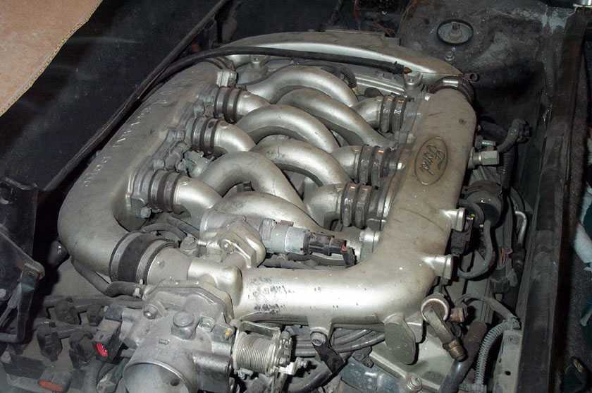

Report this Post03-12-2001 10:21 AM Click Here to See the Profile for TheFiero64Click Here to visit TheFiero64's HomePageSend a Private Message to TheFiero64Direct Link to This Post
Here is the pic. Too tight for my taste.

Report this Post03-12-2001 10:53 AM Click Here to See the Profile for rodmcneillSend a Private Message to rodmcneillDirect Link to This Post
Thats a real tight fit! I always liked the look of the intake runners on that engine however.

Then painted all the pieces with wrinkle finish black, cooked them in the oven
(to the dismay of my now-ex-wife),
and they're the pieces you see today!!
See, it's simple!
>hey is that your kit?? if so wasn't it on ebay a long time ago?
Yes, it's my TR kit. I bought the body from a guy in Chicago who had made it from IGF molds. I have the time to complete it now, and I'm keeping it!
>supercharger and punched out and stroke it to 3.4l you can get 450-500 hp easily.
Stroker crank = $3700.00 & that's nuts.
I'm looking for someone who can weld up the rod journals & offset it from 3.15 to 3.50, which together with overboring 0.122 inches, yields 3.6L.
Supercharged, that combo would need some headwork & cams plus a good header/exhaust setup & an LPM module. I'm looking for someone who has a used SC for sale. The Vortech 9psi kit is near $4,700 (again, that's nuts), so if I can find one priced less, I'll buy it.
Vortech claims: "In 9 psi trim it adds 130-140 HP and 100-110 ft.lbs of TQ."
I had contacted a local SHO club for some info, but once they found that I didn't own a Tarus, they blew me off.
If anyone on the forum knows the SHO, let me know!
>This may be a dumb question, but... How does one go about moving a firewall 4 inches?
Not a dumb question at all.
I had thought about firewall relocation before this kit, but the TR kit requires a 7.5 inch stretch, and that gave me more options. As for the actual relocation, it's just cut & weld.
Thanks for any feedback.

looks awsome in the Fiero. I like the longitudinal engine and transaxle. Lotsa work. First time I got to run a SHO I was in my AMG Mercedes SL running on interstate about 120. I was surprized to look in my mirror and see this Taurus moving up on me. I dont know if he had it stretched out but he kept rite up beside me till we both backed off.
