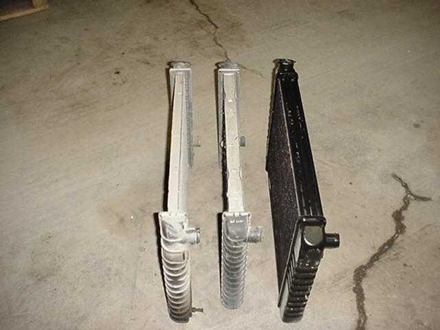

Actually both of those radiators are ONE core. The 6 cylinder Radiator just has a little bit wider core.
Here is a picc. of (from left to right) the 4 cyl. rad., the 6 cyl. rad & the 4 core radiator that I have custom made for the Fiero.
The 4 cyl. Rad. is just less than 1" wide
The 6 cyl. Rad. is almost 1-3/8" wide
The 8 cyl. Rad. is just over 2-1/8" wide
I've never cut one apart but you can look into the rad. cap opening and see the cores.

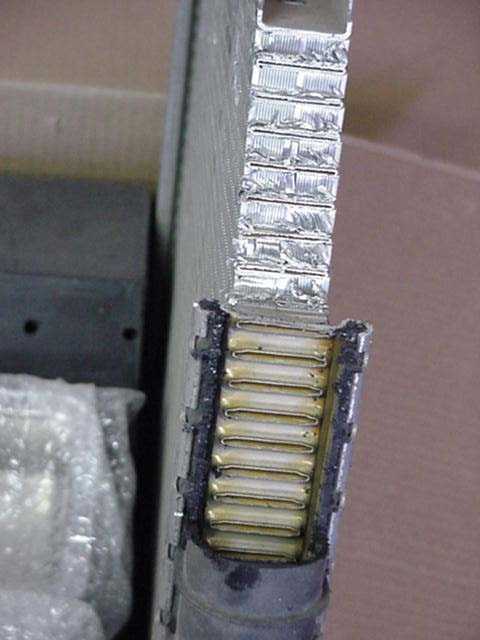

Oh, what the heck!
I only have about 60 old Fiero radiators upstairs, so why not cut one apart to see what it looks like.
Here is what that 6 cyl. rad. looks like after it's meet up with my bandsaw.
