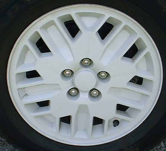

These are off a Dodge Spirit. I think they would look great on a white Fiero. FOR SALE-full set of four $50.00 plus actual shipping charges. [img]
[This message has been edited by 2M4 Dale (edited 06-04-2000).]

What would shipping be to IL. 60504???
