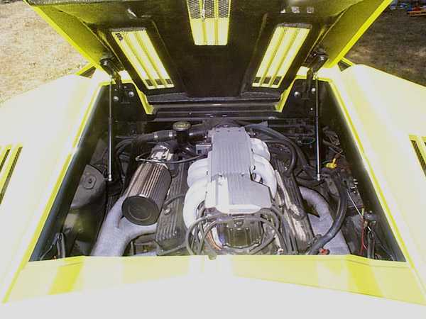

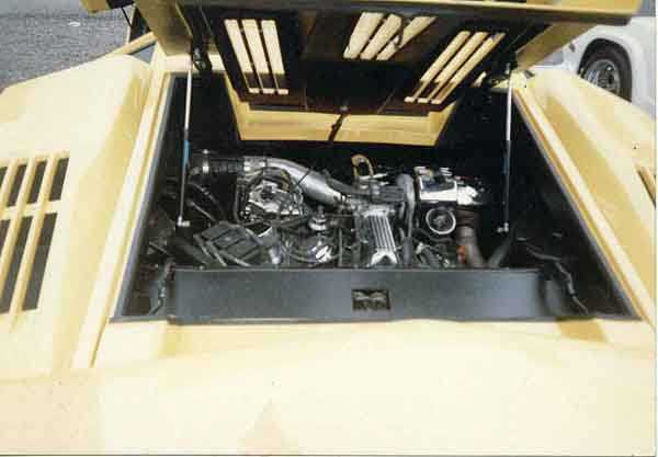

Yes, it has been done. Maybe not transverse, but longitudinally. This picture is of a GN turbo V6 bolted to a TH425 Toronado transaxle mounted in Fiero chassis.
basicly the same as my V8 swap
See any similarities?
There was a discussion about the GN 3.8 a week or two ago.
