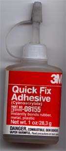

the way we repair those pieces here at the shop is to use a 3m glue, paint stir sticks and clamps - apply a small amount of the glue to the inside of the vinyl covering the outside of the piece, place a paint stick on each side of the piece and clamp.......glue sets in about 5 minutes - then glue the edge and the inner side of the piece, use the paint stick/clamp method again and in about 15 minutes you have completed the repair....
(the paint sticks are to assure a flat outer appearance - clamping with clamps of any type, even clothes pins (sorry Larry) without clamping flat will result in a wavy or "lumpy" repair (believe me, I learned this one from experience.......
Here is the glue I use........

FYI.....If ya look at the pic of the 3m glue you will see (cyanoacrylate). Know what that is? It's just superglue. you can go to your local R/C hobbyshop and buy it in big bottles, (don't buy the "thin" mixture"). They also have cyano accelerator, (Zip Kicker), in little spray bottles. It will cure the glue in 3 seconds and form a better bond. Tgowens is correct about the cyano, it works very well. Be sure to remove any foam at the joint and I do a very quick wipe of both gluing surfaces with accetone. If don't use the wood, it will be wavy.. :-(
