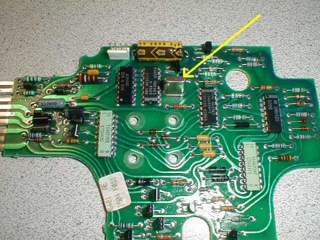

Does anyone know what crystal frequency I would need to get in order to upgrade my speedo to a different scale? I saw on an earlier thread that the 200 MPH speedo uses a 7.3728 MHz crystal. But I doubt I would ever get my lil ol 85GT up to 200 mph. Maybe go to a scale like 140, or 160? Any info would be great!

Correct me if I am wrong too please, but the yellow arrow points to the crystal, right?

Sometime back I posted a $10 circuit using a 74LS628 VCO chip that will replace the crystal entirely. You can basically dial up whatever full scale you want.
I used it to make a Canadian 170kph and 140kph speedo read in MPH in my Ciera GT. There is enough range that a 200MPH (although a little pretenious) is possible.

Thanks for the info Terry, is the 74LS628 VCO chip readily available, and is it easy to install?

You would have to build a little circuit around it. About 10 parts (resistors and capacitors). The prices I've seen for the LS628 is about $2-3. I wouldn't both unless you are building a non-standard full scale speedo. This method keeps the odo and trip correct.
If you don't care if the trip and odo are wrong, you can rescale the meter itself with a pot.
