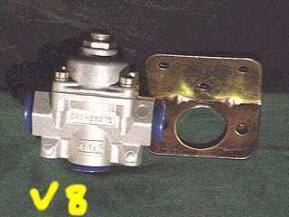

This is the one I have with a 4 cylinder fuel pump. The center bottom inlet says "IN"
and the other side outlets say "OUT"...should I still block one outlet or simply hook up the larger line to one side and the "return" line to the other side?
I suspect I have to have for the carb and the other one for the return line...does anyone one if these are factory pre-set at 8lbs? It's a holley fp.Brand new.

Zorba, the regulator you posted (pic) is generally used with a twin carb setup. 1 inlet with 2 outlets...(each outlet feeding 1 carb) Sandy
