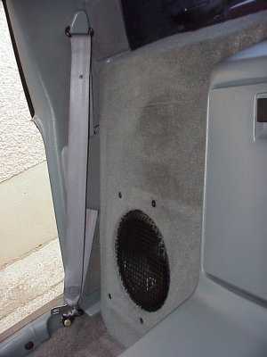

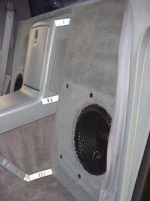

People have been asking this quite often, and the photos on my website obviously don't show clearly this information. I had my seats out to shampoo the carpet and took new photos as below.
At location I & II it is 3 inches from the FRONT of the console to the front of the sub-box. At location III it is 4 1/2 inches from the bolt center to the front of the sub-box. In the second photo you can see where the front of the sub box is relative to the seat belts on the side panels.
These are boxes using the OZ Audio 250L subs. These are only 4 3/4 inches deep, and have excellent specs. http://www.sounddomain.com/shopping/product_details.cgi?sku=OZA250L&sidebar_
If you use a monster 15" long throw sub-woofer with a basket 8 inches deep, your box will have to be significantly deeper

I attached the boxes to the firewall with sheet metal screws, but I used alot less than Loki http://www.cox-internet.com/fiero/mystereo.htm and once they're in, they're there forever!!
I covered them with unbacked carpeting, using a high quality spray adhesive. I also recovered the door panels with the same material. As I had installed speakers in the kick panels where the footrests are,
I ordered new matching carpet without any footpads as well.
There's work involved in putting subs behind the Fiero seats. Check my website below:
http://www.geocities.com/fierosound/
If you decide to install subs this way, here's a better breakdown of the work involved.
Tools you need:
- electric drill and bits
- electric hand jigsaw - wood and metal blades
- table saw or electric hand saw
- hand saw
- tape measure
- 3/4" MDF panel (Medium Density Fiberboard)
- wood screws, metal screws, wood glue, silicone
- cardboard from appliance box is useful
The interior of the Fiero is not "square", so I can't send exact sizes for anything. You have to build the boxes into the car while the interior in the rear section is removed. Removing the seats gives more room. If needed as a daily driver, you may have to remove/reinstall driver's seat several times as you work.
Once the interior is out, what needs to be done becomes obvious if you follow the information at my site.
The gas filler pipe runs through the area on the driver's side - be careful!! To cut out the firewall, drill a small hole about 12 inches up from the floor. Insert a wire coat hanger to "feel out" how large an area you can cut out. Use and electric hand jigsaw. It's better to start small - you can always cut out more.
The "well" is in an 8" or 10" inch channel supporting the firewall. Each end needs to be sealed. Cut some MDF to fit and silicone into place. Some people are using fibreglass to to this - probably easier. You need to seal this - otherwise all your bass will be "outside". There is limited space for speaker magnets. Buy high efficiency speakers with small magnets. I recommend OZ Audio 10" 250L subs because of their excellent specs. http://www.sounddomain.com/shopping/product_details.cgi?sku=OZA250L&sidebar_
"Try out" how/where speakers will fit and take measurements. You can use cardboard to help "size" the box you will need to build. This can then serve as a template to help build the MDF enclosure.
Build the "frames" first - make sure they fit properly. It'll take time to shape and trim them to fit snugly against the firewall. THIS IS THE MOST TIME CONSUMING BUT MOST IMPORTANT PART!!!
Attach to firewall with sheet metal screws. Don't forget to get your speaker wire routed into the sub box at this time. Seal firewall/frame joint with silicone to make sub box airtight. This is where proper fitting helps installing and sealing.
Make your front panels. Also determine what you will do across the top below the window to finish. Keep in mind you need to install speakers from the front - so you can remove them for replacement. Determine how you want to mount speaker:
- surface mount with grill
- sunken with custom grill panel
Check for clearance/fit of panels to center console, wall panels, etc. Attach speakers to panels and check again, making sure everything fits/clears. Make adjustments as necessary so everything fits. Remove speakers (to prevent accidentally damaging them).
Attach front panels to frames with glue/screws. Install speakers again and test run - check for rattles, etc. and fix if any. Remove speakers (to prevent accidentally damaging them).
Cover the sub boxes with covering of your choice. Unbacked carpeting is best and easiest to work with. It can be cut easily, stretched around corners and will hide small imperfections. It can be bought from car upholstery shops and Car Audio stores in a variety of colors. Use a good quality spray adhesive.
Cut and reinstall carpeting - leave enough to tuck under/around edges sub boxes. Install side panels and center console. Install speakers and grills. Reinstall seats. You're done!!!
Hope this helps,
Good luck.
fierosound
Calgary, AB
[This message has been edited by fierosound (edited 12-16-2000).]
