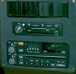

Report this Post10-11-2000 11:16 AM Click Here to See the Profile for TheFiero64Click Here to visit TheFiero64's HomePageSend a Private Message to TheFiero64Direct Link to This Post
Look at how my radio looks. It came out of a 96 Grand Am It lights up the same color as the rest of the dash too.

Report this Post10-11-2000 11:17 AM Click Here to See the Profile for TheFiero64Click Here to visit TheFiero64's HomePageSend a Private Message to TheFiero64Direct Link to This Post
TheFiero64
1345 posts
Member since Mar 2000
Forgot about the link to where I got it from http://www.aatechnologies.com/pmyradios/pontiac/16205302.asp
