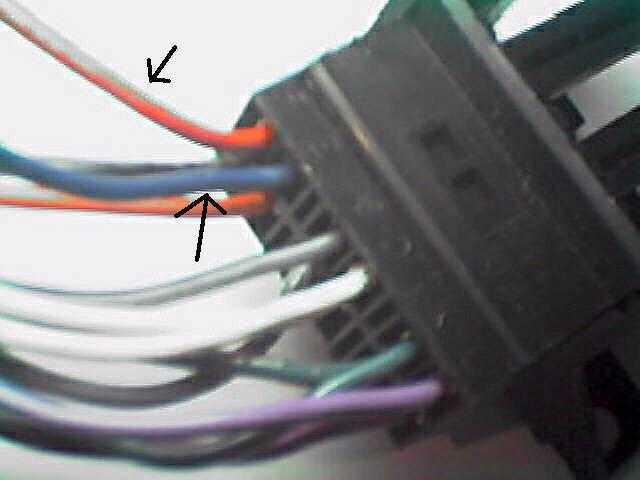

Seanh
1557 posts
Member since Jul 2000
Perhaps this pict will help you. The black harness you see to he right is the side that will plug into your factory harness on your car. If this harness is labeled with letters, on the plastic above to wires going into it, you should cut the wire into letter "E" about 2-3 inchs above the harness, then make a splice into letter "F" and tape the connections. In the following pict. your would cut the blue wire (bottem arrow) and hook it into the red wire (top arrow), once you do this be sure to tape off the other end of the blue or "E" wire so it wont short. Email me at sean@kdsi.net if you have anymore problems or dont understand somthing.
Sorry about the size and quality of this pict. I am on a crappy computer.
P.S. Probally should have said this more clearly, but just to make sure: Cut the blue wire in half tape off the end comming from the cd player and hook the other end into the red wire. Do not cut the RED in half, just bare the wire and wrap the blue wire around it several times, and tape good. Only cut the wire in the aftermarket harness you purchased. This is a lot eaisier to replace then your factory or cd player wiring.

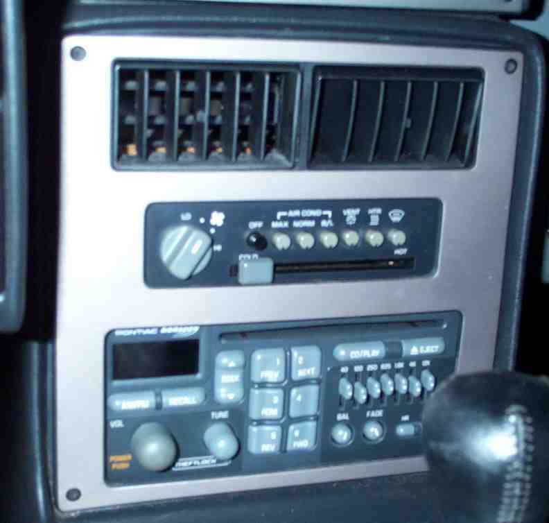

OK guys, here is the radio. I know it's hard to see but in the upper left of the radio is says: PONTIAC Monsoon. It looks like it belongs there.

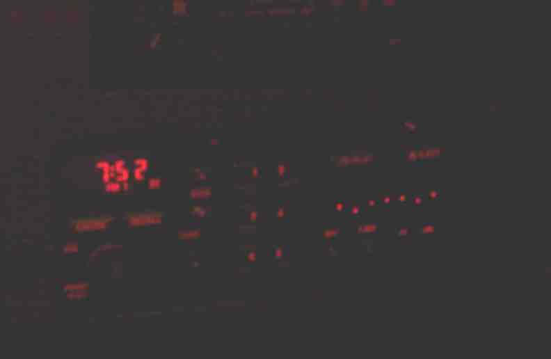

Here is a night shot. Not too clear but you get the idea.
